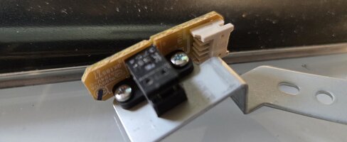

Thanks Hat! I think you are right. The little board that has the slit that read the disk appears to be broken. I need to get that out of the and try and solder it back together I think. Those screws are beneath the bottom case though so I don't know how to access them other than drilling little holes in the side. Here is a picture, but I'm not sure if you can tell what I'm talking about in this picture. Let me know your thoughts. Thanks

If you’re having trouble getting the screws out, then dremel the unit off and repair it and then glue it back into position with a two part adhesive..

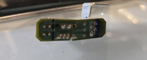

Ok, I got the piece off. The chip is broken, but I should be able to glue it back together. Should I check it somehow with my multimeter? See attached

Here is one other angle that may help. Thanks
