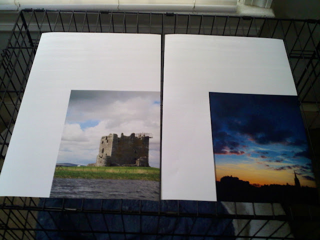

Just so people can see, this is what is happening...
And no, I made absolutely sure the paper selection was 13x19" size and image was "fit" on the page. Worked fine in WinXP Pro installed on a AMD Laptop I had. Been exchanging emails with Canon for a week now, and got the following from one of their techs:
"I personally have never seen this occur."

You can tell them that you aren't the only one who has seen this.
That's exactly what happened to me when printing full size prints from my Win7(x64) machine to my i9900 connected to a networked XP(x32) machine, even though it printed properly using the same program running on the XP server. After removing and reinstalling the (same) driver on the XP server, it now prints properly from Win7 (at least the last time that I checked).
camstone
Sep 5, 2010
9
"End Game"
So what I finally did was install VMWare and a image of WinXPPro 32 bit, and ran the drivers that Granddad35 recommended from that virtual image, inside a win 7 window. Worked fine, printed a full 13x19, and I can live with the overall performance like this. Canon realized they had a problem, but wanted me to call their tech service for support on it. Not really sure why I can't get an answer via email... but maybe I'll call them once I get back from business travel.
