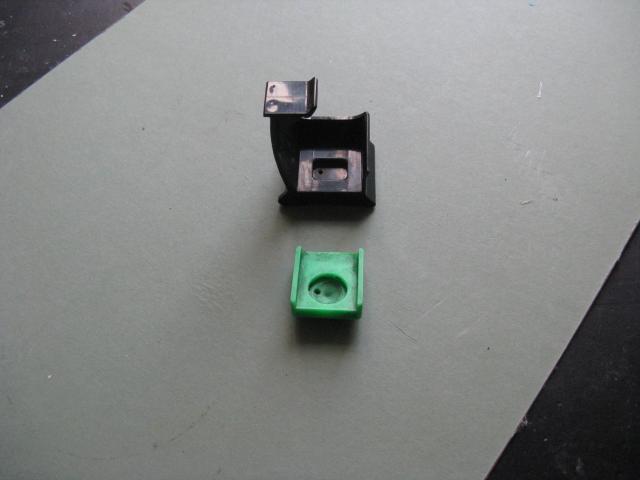

barfl2 said:
Thanks for the pix, they really help understanding what's going on here.
Could we have one more of the bottom of the clip showing the connection to the syringe but without the syringe?
Is the insert made of a soft, pliable rubber-like material so that it will provide an adequate seal as well as provide the guide and correct spacing for the different cartridges?
My only concern with this gadget is the small hole that the ink and air have to flow through.
I still may order some of these and thanks for all your help on this.

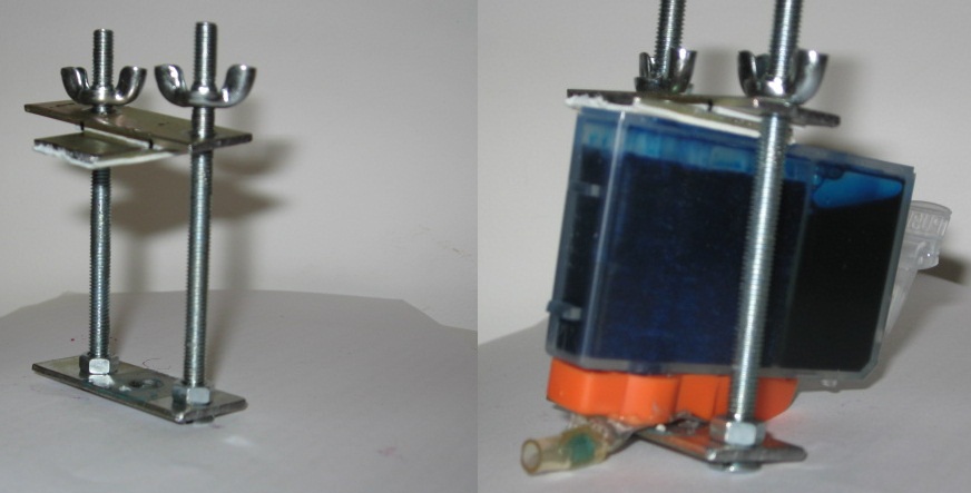

My third attempt to "Freedom Method"
Although I intended to do it by the book, it was not possible as I have not found 60 cc with long tip syringe (btw, it is called catheter tip syringe or in my area Guyon syringe).

gigigogu said:
To overcome these I build a holder as in picture below, to secure fit the orange cap on outlet port and the adhesive tape on air maze.
http://www.nifty-stuff.com/forum/uploads/8054_holder.jpg
Before I came up with my final configuration, I retrofitted a similar orange cap but I had to hold it on with rubber bands (you have been quite ingenious in your fixture) but I found it too fragile and prone to leak. The rubber hose solves all the problems.

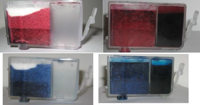

gigigogu said:
Also I used a 30 cc syringe from a refill kit.
And it worked like a charm.
http://www.nifty-stuff.com/forum/uploads/8054_cartridges.jpg
I'm a little concerned that you have really saturated your upper sponge. It's easy to do but when you can watch the process, you can control how much ink goes into the sponge area by slowing down the process when the ink starts to saturate the upper sponge. I think maybe you had a better seal on the air vent than I do which in my case might help prevent getting ink in the white part of the sponge. Most of the time when I do it, the refill cartridge looks just like an OEM. I showed pictures of both sides of the cartridge I refilled in the video in post #44.
gigigogu said:
Some observations:
- it is mandatory to have everything airtight, the plunger in syringe, the connection to outlet port, the air maze.
- at least 30 cc syringe. Tried with 20 cc syringe with mixed results.
- regarding foam, maybe my ink is "foamy", or has a volatile component that boils at low pressure.
- it is easy to overfill (ink in space above sponge, up to air maze, happened to cyan cartridge) so I suppose the method cannot be used for opaque cartridges.
IMHO this method is very good for persons who refill other people cartridges, as there is no need to do anything to cartridge (holes, plugs) and the refilled cartridge is in original state, but not so good for people who refill again and again the same cartridges.
ghwellsjr, congratulations!
Well, you have described my situation quite well but now that I have figured out how to do it, it will be the only way I refill, even for personal use.
I don't see why this method wouldn't be perfect for opaque cartridges. Even if you do get ink in the air space or in the air maze, it is very easy to clean it out. I described this process in post #15 and others but to re-iterate, when you're done refilling, you need to remove the tape over the air vent, turn the apparatus so the cartridge is upside down, pull back on the plunger to remove any ink in the serpentine path, turn the apparatus right side up, pull on the plunger some more to remove any ink in the air space and to remove any oversaturation of the upper sponge.
Unlike the injection refill methods, this method will never get so much ink in the cartridge that it starts spilling out and you can remove the excess ink with the simple method I described above.

barfl2 said:
ghwellsjr Inktec clips confirm rubber inserts are fairly soft AND ARE SIZED TO FIT THE RELEVANT CART. Hole size in the insert is approx.0.078" and may be the restricting factor to using this system for your refilling method
http://www.nifty-stuff.com/forum/uploads/5268_hp364-inktec-clip_005.jpg
another view
http://www.nifty-stuff.com/forum/uploads/5268_hp364-inktec-clip_006.jpg
I have had similar problems locating supplies in the UK my budget does not extend too far and its pointless buying large quantities of materials. But the tip about medical supply stores is useful. Gigigogu adaptor was very interesting and probably used materials he had to hand. I like Engineering solutions. I machined a adaptor to fit compatible BCI-3bk (with nibs removed) later found that the Canon OEM is a slightly different size. Should have measured several before starting.
Its good that other Forum Members are achieving sucess.
barfl2
Many thanks once more for the excellent pictures. The hole in your top picture looks very big but that's probably because it's a closeup. Doesn't the hole fit a normal sized syringe? It's not Luer Lok, correct? Just a smooth round hole? I could not stick my large syringe in it unless I used the blue adapter as shown in the last picture in my first post, correct?
I'm concerned about your comment that the compatible BCI-3bk was a slightly different size than the Canon OEM and that apparently affected your machined adaptor. This will have no bearing on your previous statement that the Inktec clip will correctly hold Canon OEM carts with the appropriate insert, correct?
