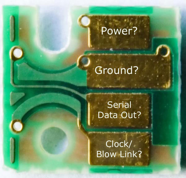

fotofreek said:
Just picked up the following post on the printer newsgroup - anyone tried this?
There are 4 pins on the chip: Vcc, GND, CLK and Data. The GND pin is the
longest one, the second from the left. I put a tape on this GND pin to make
it not contacted, but the cartridge still works fine. The cartridge is
recognized; the red light is on; the printer is still able to write to the
chip (yes, I confirmed this).
I also tried to cut off all the traces to this GND pin (see the picture),
the same.
What's going on? How could any electronics work without a return ground?
http://lh4.google.com/fixup77/R8tZNofu6zI/AAAAAAAAAN0/Sb27A3OO4Q0/s800/IMGP0221.JPG

[fotofreek]
There are 4 pins on the chip: Vcc, GND, CLK and Data. The GND pin is the longest one, the second from the left. I put a tape on this GND pin to make it not contacted, but the cartridge still works fine. The cartridge is
recognized; the red light is on; the printer is still able to write to the chip (yes, I confirmed this).
I also tried to cut off all the traces to this GND pin (see the picture), the same.
I done a research ..
Oooh I see a mistake here , If you look again to the picture that confused us see below .... the CLK with the Data pin uhmm this is not right .. i have found that photo one is a wrong copie ... see the differance :
The confusing picture !
The true real picture ! :cool:
And your picture :
The 4 pins ( in the cardrige adopter ) and your picture , starts from the right to the left
1 - Vcc is on ( pin 1 )
2 - Vcc makes 3.3 volt with the DATA ( Pin 2 )
3 - Vcc makes 3.3 volt with the GND ( pin 3 )
4 - Vcc makes a 1.65 volt brige with the CLK ( pin 4 )
I be able to look into the printer ( canon ip4300 ) after some difficulty removing the sheath but good to know this has almost the same lip / klik places ( 6 ) as a ip4200 PDF document shows .
.. I used a ohm meter and suprisely the DATA pin has 102 ohm at the end of the line ( flatcable) ..
- I found out that the right pins of the cardrigeadopter , ( the 3,3 volt VCC) is afailable in not one but split in two lines in the finnest ( disconected ) flatcable .
- The (Ground) GRD is in connected in two of the 3 cables , 1 in the finnest flat cable and 5 in the other .
:mad: These photo explaining pictures are so wrong .. sorry ;)
