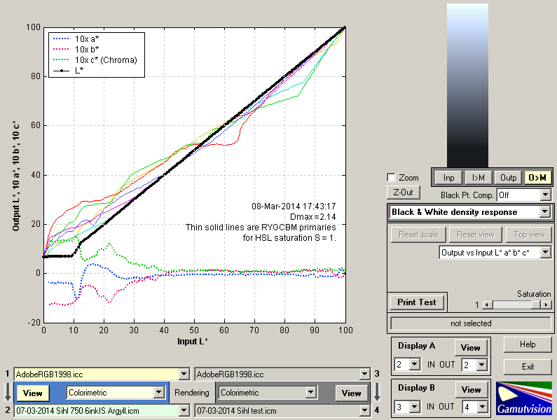

Thinking about it a little more, perhaps the best objective is to aim for a straight line between 100% L and Dmax, as shown in this image by the orange line.
This would give a linear grey gradation down to Dmax and would require Argyll aiming for Dmax=2.14 rather than zero. A point that Argyll should know from chartread.
Isn't that what the perceptual rendering does? Colorimetric aims to reproduce all in-gamut colours precisely, which your orange line fails to do.

Perceptual rendering will certainly map L=0 to the printer's maximum black, but in my experience the linearity is never as good as the Colorimetric rendering - present examples excluded! BTW, for testing your greyscale print you may find the Northlight Imaging test image slightly more revealing. http://www.northlight-images.co.uk/article_pages/black_and_white_test.html
Following the possible comparison of CM and i1Pro, I've just tried a different approach. I used Emulator's excellent batch file to create the 750-patch target on a single A4. Unfortunately, my i1Pro would not read the chart successfully, with too-frequent "Too many patches" errors. I must say that I have never seen too many patches before - maybe something to do with the coloured spacers between patches.
I also printed a chart using 870 patches on 2xA4, measured it and created a profile, again using Emulator's batch file. The Gamutvision B&W response is shown below, and I must say that it looks extremely good, right down to Dmax. In fact, this profile, at least according to Gamutvision, is better than my previous 918-patch effort, even giving a (very small) increase in gamut. All credit to Argyll. So, it looks as if the strange behaviour in others' B&W response may well be caused by the CM.

The reason I suggested this was to see if a target read using a different instrument would eliminate the dog-leg in the shadow region. This seems to be present in both Pharmacist's and Emulator's profiles and it isn't obvious whether it's a problem with the CM of something in Argyll itself. Do your profiles suffer from this dog-leg?
I thought the "dog leg" was due to the measuring instruments inability to measure a luminance of 0. That's why I use a DTP94 to cal my monitors (known for having very good low light noise response).
