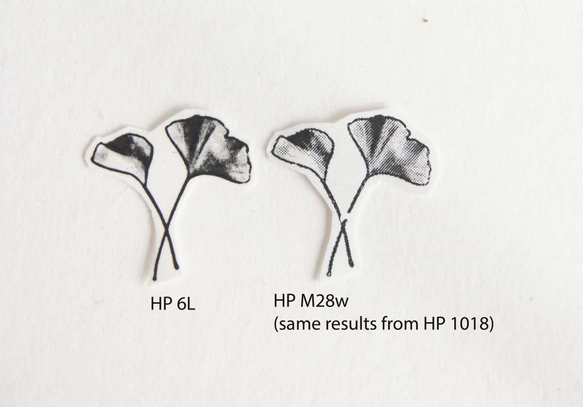

Hi!
I've always used an HP 6L to print small detailed images for my jewellery design business. I've been having new issues with the printer and so I've started trying to find a replacement. Both my HP 1018 and HP MFP M28w print fine except that with images, you can see the dots. The images are not smooth. Increasing the resolution has not helped. I've tested different drivers, different settings, different apps. I'm using Mac OS 10.12 at the moment.
I would appreciate any help or a point in the right direction.
Thanks,
Leila
Your HP 6L appears to be printing halftones using the Floyd-Steinberg dithering algorithm (https://en.wikipedia.org/wiki/Floyd–Steinberg_dithering), which is arguably the best one for the job. HP M28w, however, uses a generic dotted halftones pattern. The difference is caused by the printer drivers, actually, not the printers themselves.
It is worth noting that both printers are capable of printing the images identically, if you do the pre-processing yourself in Photoshop by following these steps:

Your HP 6L prints halftones using so called Floyd dithering, which is, arguably, the best dithering algorithm. HP M28w, on the other hand uses generic dot-bases halftoning
Your HP 6L appears to be printing halftones using the Floyd-Steinberg dithering algorithm (https://en.wikipedia.org/wiki/Floyd–Steinberg_dithering), which is arguably the best one for the job. HP M28w, however, uses a generic dotted halftones pattern. The difference is causes by the printer drivers, actually, not the printers themselves.
1) Convert the image to grayscale
2) Resample the image to use the target image size and native printer resolution (such as 600 dpi)
3) Convert the image to black-and-white, using the appropriate dithering algorithm
4) Print without scaling, at 100%

This is amazing information. Thank you. Is it possible to add a dithering algorithm to photoshop or do I need to work the with the options available?
Yes, it is possible. "Diffusion Dither" is the Floyd-Steinberg one. There are 3 other built-in methods, or you can create a custom one:

I'll agree with the halftone assessment, as well as dithering.
In the infancy of printers becoming common in businesses, then consumer-grade,
it was common for printers to use halftoning and dithering heavily.
This put a more realistic image to the paper as desired by most users.
It made for a better film-photographic representation than a digital graphic.
A good example was my old HP LaserJet 6.
A monochrome printer, it produced very good quality B+W images on plain paper.
Later monochrome printers began printing less of the dithering and grayscaling,
with dots of old newsprint becoming apparent.
As time has gone on and digital images have become more detailed,
so has the printer industry been moving away from the smoothing
technologies they used to so heavily feature.
Nowadays, I wouldn't expect to find halftone and/or ditering options available for
most laser printers or ink printers, although I'd suspect they have been rolled into
similar functions which have been renamed. More likely, I'd expect such options
to be coming from a program/app generating a print, and not from a printer
driver itself.
I use an ancient version of Paint Shop Pro(7.x) and Photoshop CS6.
The differences in print output from each are very different on modern printers,
which seems to support an app-level driver as opposed to device-level drivers
beginning from about the era of Windows 98.

Interesting! I am beginning to understand that it's not so much about capability but what the manufacturer choses to include...based on the main category of consumers. For instance, I tried to find an inkjet that ticked all my boxes but some of the attributes were only on 'home business' printers and some were only included in the 'home artist' printers.
I am also using and old Photoshop (CS5).
