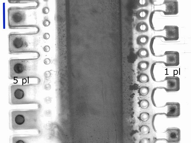

Side track a bit. Nozzles was discussed and mentioned above. What would the size 1 pl nozzls, 2 pl nozzles, 3 pl nozzles and 5 pl nozzles if we were to imagine/associate them in terms of millimeter? Hmm, 0.01, 0.1 millimeter for 1 pl nozzles???? By the way, I have already read ghwellsjr's post on Antomony of Canon Printhead Nozzles so no need to link me to that thread. However, despite having read ghwellsjr's post and also because the nozzles are so tiny that they cannot be seen directly with physical eyes, I want to imagine how tiny they were preferably in terms of millimeter.

This post shows several additional photos of a print head. In particular, this photo
Shows the sizes of 1 and 5 pl nozzles. The blue bar at the top left of the photo has a length equal to the spacing between nozzles (1/600 inch), so you can scale the diameters of 1 and 5 pl nozzles from the photo.
