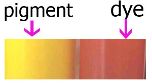

Another question I like to ask, I noticed also that Epson Pigment Ink is usually more Opaque while Dye Ink is usually a bit 'translucient/liquidity'. I wonder if it's this composition that makes the Espon Pigment Ink not possible to use directly on Canon Printer because Epson Ink wouldn't flow through the Canon Printhead nozzles.
Should I eventually consider to purchase the Universal Color Fast Ink (3 colors), I will be missing the pigment black, is there no way to modify the Epson Pigment Ink so that I could use it on Canon Printer?
