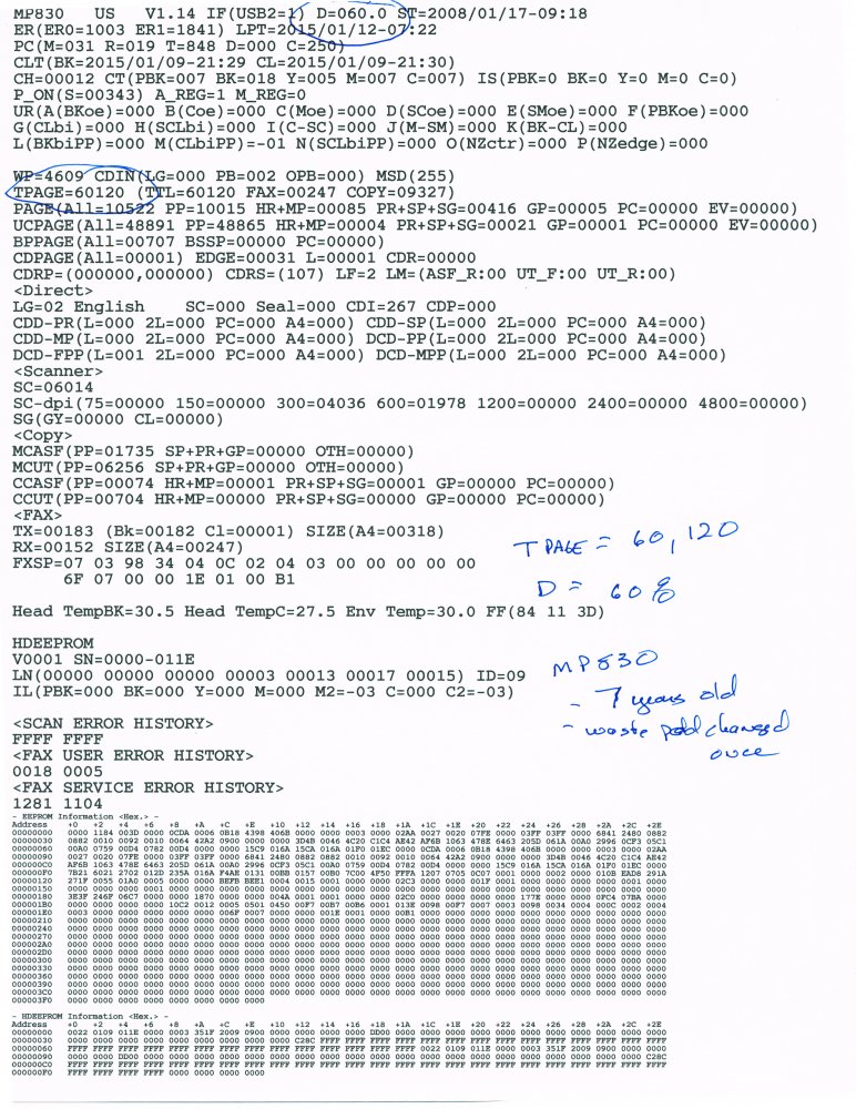

been a while, just sharing some printer longevity numbers, see attached eeprom printout
MP830:
- 7 years old
- 60,000 pages printed
- D = 60%
- purchased refurbished for $99 directly from canon
waste pads were changed once already at 37,000 pages
http://www.printerknowledge.com/thr...-pad-replacement-at-37-000-pages-w-pics.7646/
more numbers:
- have refilled 400+ ink cartridges over the 7 years, using only 9 OEM ink carts, 2 of the CLI8 carts are original, on 4th print head
MP830 keeps going and going, my only problem is that i take this quality printer and the easy refills for granted
any other printer longevity numbers ?

jimbo123
Dec 2, 2007
489
390
223
USA - NJ
MP830 MP980
actually my print head number for this MP830 is more like 2.5 print heads.
i had a previous MP830 that died(logic board) at 22,500 pages, i then swapped over the print head and carts to this MP830

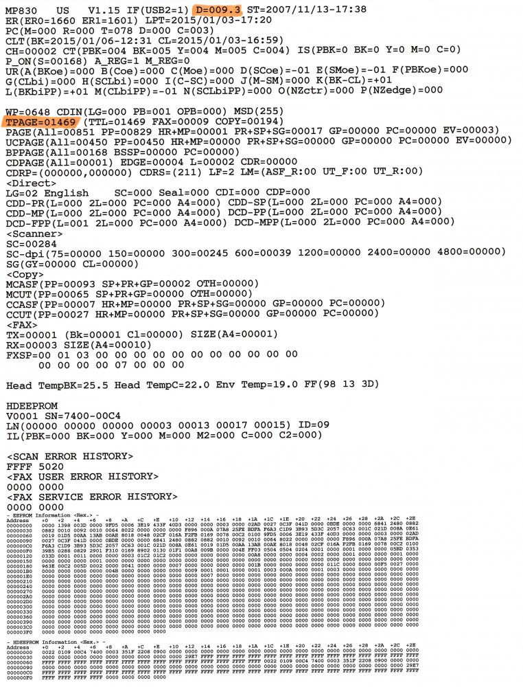

7,171
:bow :woot
My printout below. She's older than yours, Jimbo, but still has that new printer smell. :D
(Refurb model recently put into service)
jimbo123
Dec 2, 2007
489
390
223
USA - NJ
MP830 MP980
take care of her, they don't built them like they used to.
should be good for another 58,000+ pages !
nice !
J
