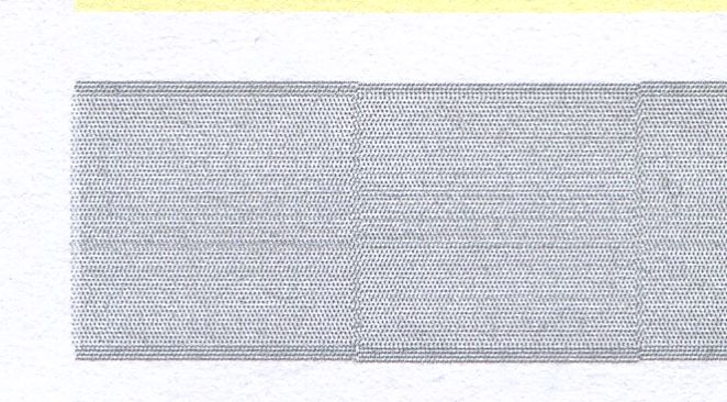

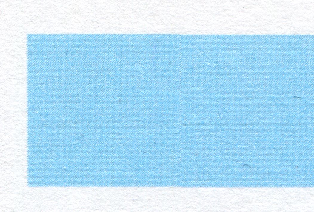

Now I can also see the problems with the cyan nozzles. It looks like a worn printhead to me. But it is very difficult for me to see. I think it is the limits of what your scanner, my monitor and also my eyesight can resolve. I also think the paper structure is of importance. High resolution paper or photo paper might show the defects more clearly.
Here is cyan nozzle check from an MP980 scanned at 1200 dpi on an Epson V33 CCD scanner, click to enlarge. Notice vertical division.
And here is photo black from the same printer in 600 dpi. Notice defects and the larger droplet size, click to enlarge.
A nozzle check on photo paper might show possible defects more clearly in a high magnification/resolution.
On photo paper it seems the Lucia inks are not very well suited for the Maxify :(.
