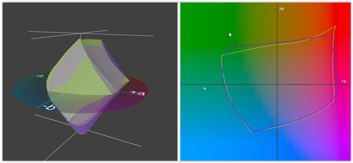

I spend all evening finding out where the difference between my first calibration (with mostly OEM) and the last (with Octo CO) that @Ink stained Fingers found could come.
Added OEM C,M and Y (recovered from empty carts from eBay).
You can see the additional color space but not all was recovered.
Added OEM PC and PM wich only very slightly enlarged the gamut (won't show the pic).
Printed the test chart again
I do not see any difference !
I could eat the strawberries (as @jtoolman says) from every of the about 20 prints I made .
IMO this test chart lacks also large blue, green and yellow surfaces to judge.
And if I do not see - on the real print under a truelight lamp - any difference that could even so good have been caused by a slight move of a slider in the editor or a slightly different print profile or setting (let be the difference between perceptual and relative intent), how could @jtoolman and @mikling prove differences between inks this way on youtube ?
The only thing that was visible immediately after my first test was the deepness of the black (in the upper corner) between Octoinkjet Standard Black and OEM PBK.
