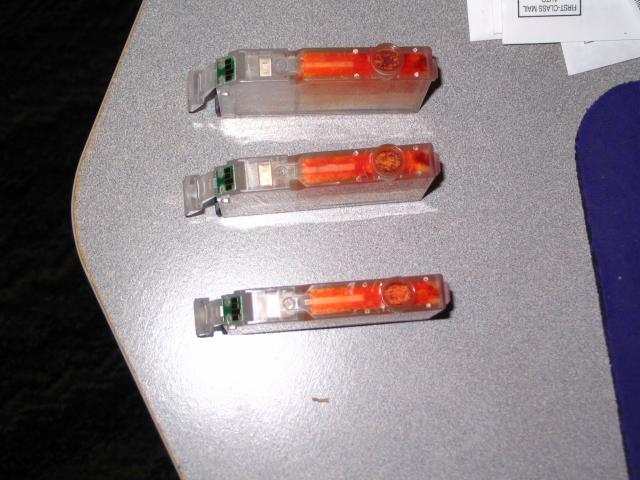

2. The Canon virgin empty cartridges (PGI-5/CLI-8) I bought on eBay were listed as fresh empties and they all look fine except the yellow carts, the outlet port sponge on these carts seem to be shriveled up some. Once refilled with ink will they come back to life?

I'm terrible at taking pictures but this is the best I can do
I haven't tried washing it out but it looks like it's dried out to me I'll just go ahead and fill one with ink and see what happens.

I have tried zooming in on your picture but I don't see anything wrong with the outlet ports. They normally have two small plastic protrusions on the sides to hold the sponge which is maybe what makes you think the sponge has shrivelled up. The sponge itself just looks dried out to me.
Without seeing them close up it's hard to tell. You could open up the top refill hole on one cart as a an experiment and flush the cart. Then fill or plug the hole and fill by the German method.
NOTE - When you refill the first of the carts check ink will flow by pressing the outlet port gently against a piece of kitchen roll or tissue. After that leave the cart right way up for a few minutes to check for any leakage, you should not see any. The last thing you want is a leaking cart in the printer!
When I put my first refills in the printer I checked it a few times that day and next day before being satisfied that they were OK.
