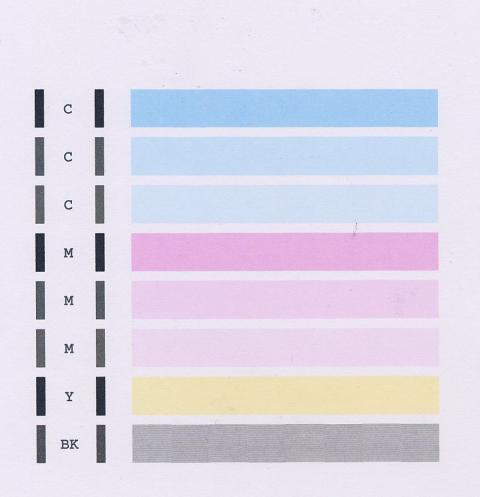

I'm thinking that losing the ability to view ink levels probably disappeared BEFORE I lost the ability to print black from the PGBK cartridge. The reason I say that is because I used to get a pop-up saying the printer was preparing to print a document using the iP4500 printer before the printer actually started printing ... and, there used to be an icon in the system tray for the iP4500 printer that I could right-click and bring up My Printer (I think) .... and seems like I "lost" both of these items some time ago, long before I lost the pigment black printing.
bankerjohn
Sep 20, 2012
13
22
Here's what my nozzle print looks like:
15,907
8,916
Now were getting somewhere so its back to the black cartridge again.
Did you try a new or replacement cartridge so as we can eliminate that first.
turbguy Sounds like a classic purge unit issue to me!
The purge unit would then be the next port of call.
I started with #3 ... flooded the purge pads with water, and then executed a cleaning cycle. Nozzle check printout still completely missing the top line where the PGBK cartridge is supposed to print. Checked the purge pads and the water is gone, so I assume the purge unit is functioning correctly.
OK ... I installed a brand new PGBK cartridge ... genuine Canon, not refilled ... absolutely no difference ... no printing from PGBK cartridge at all!

I started with #3 ... flooded the purge pads with water, then executed a cleaning cycle. Nozzle check printout still completely missing the top line where the PGBK cartridge is supposed to print. Checked the purge pads and the water is gone, so I assume the purge unit is functioning correctly.
Before I proceed to try other possible solutions, one thing that no one has responded to is my concern that My Printer software is no longer allowing me to view the ink levels. When I click on Printer Status, nothing happens. In the past, this would bring up a window showing the ink level on each cartridge. Is there a possibility that my driver file has become corrupted? Should I attempt to uninstall the "Canon iP4500 Series" program, then download and install the current version? ... before I try anything else?
It is important you follow explicitly the instructions in #3 and not do anything else such as printing something. The idea is to isolate the function of the purge system as best as possible with this test.
Reading your subsequent posts, and if I understood you correctly, the purge system seemed to work properly. You flooded the purge pads and the pooled water stayed on top of the pads. If you close the lid of the printer, the printer may purge some ink as part of a routine maintenance from having the lid open - you will hear the printer grinding and click-clacking similar to when you first turn it on. The pooled water will now be sucked into the purge system. In this instance, you won't need to run a cleaning cycle, but it is often instructed to do to make sure things are working properly. At this point I don't think you have a purge system issue based on all your posts.
You have now tried a new pigment black cartridge and nothing was printed out in the nozzle check for pigment black. This leads to the possibility of a clog in the print head, a print head failure, or a logic board failure. Soaking the print head is the next logical step (unless you have a replacement print head handy).
