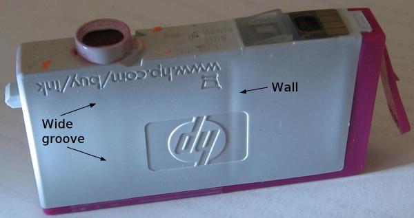

Agreed, one can find the needles, although you have the difficulty of that long probe, and some people claim that you can mess up the top of the filter or the sponge around the filter. I suspect that most refillers could manage to drill a good diagonal hole. You need to start with a pilot hole part way through the wall but straight in. In some cartridges you can see the divider wall (see HP picture below), so the target should be easy enough to find. Of course, I'm speculating. I haven't tried either way yet.

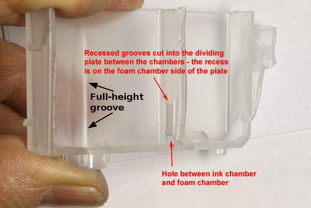

ghwellsjr said:
I have never observed any grooves in a Canon cartridge that go all the way from top to bottom. Could you point out where you see these in one of the pictures?
This shows it pretty clearly, on a Canon cartridge. If you look closely, you can also see some internal details from the outside of an HP cartridge.
(Click to enlarge)
ghwellsjr said:
The recessed grooves only go half way up the dividing wall in a Canon cartridge. So it ends just below the top of the lower sponge.
It should be clear now.

I think ink flow and air flow is simple as that:
The saturated lower sponge seals the ink chamber from getting more AIR, therefore no ink flow from ink chamber to the outlet WITHOUT printhead sucking.
Air from sponge chamber to ink chamber - and therefore ink from ink chamber to sponge chamber - is only flowing when the lower sponge gets DEsaturated to the upper end of the grooves.
A third party cartridge without grooves will give air and ink when the sponge gets DEsaturated down to the passage.
ghwells did mention the air bubbles in a "groovy" cart appear more constantly while in a cart without grooves more abrupt.

@ ThrillaMozilla
Nice spot on that full height groove, as you call it, on the BCI-6 cartridge I cut open. I hadn't noticed that. It's a very shallow recess in the cartridge wall and tapers to nothing just below the top edge of the upper sponge.
The cartridge is a genuine Canon one, not a Canon-compatible.
Something occurred to me as I was looking at the cartridge again. In its assembled state the ink chamber appears to be completely sealed at the top, in fact it would have to be or we know that ink would drain out and flood the printer. That being so, am I right in thinking that in use, and as the ink level drops, the air pressure above the ink will reduce to below atmospheric pressure?
If the pressure does drop as ink is used, how does the ink then flow from the ink chamber into the sponge chamber or is the reduction in pressure simply not enough to prevent this happening? And if I am wrong and the two pressures are identical, how does the air pressure above the ink get to be the same as the air pressure in the sponge chamber without the ink draining out of the feed hole?
Just me pondering ...
Paul

paulcroft said:
...am I right in thinking that in use, and as the ink level drops, the air pressure above the ink will reduce to below atmospheric pressure?
Yes, there's a partial vacuum. Without the sponge, the vacuum would exactly counterbalance the difference in ink height between the two chambers. This must be true because the pressure in the sponge chamber is atmospheric. (Of course, the sponge complicates this a bit.)
Assuming the sponge chamber stays at atmospheric pressure, you can't get much ink out of the chamber unless you replace it with air. So I think most of the ink comes from the sponge at first, then once sufficient ink is drained from the sponge, air can get into the ink chamber. This is simplified a little because the sponge complicates everything.
