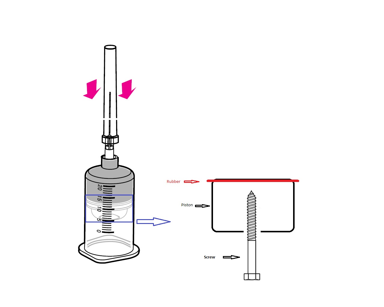

barfl2 said:
Those Intec thumb syringes are great because they have so little overhang compared to a conventional one. I assume you cannot refill them?
I love those syringes too. Here is how I do it:
Insert screw, fill syringe, remove screw and it's ready to go again.
