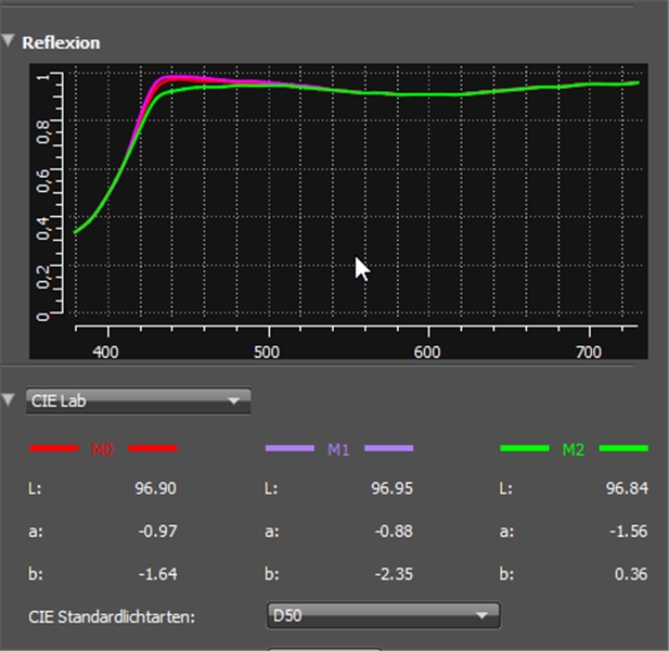

I compared the CR674A and CR672A HP papers - they both have a very low (or zero) OBA contents, here are the spectral displays of the white paper
Here the CR674A paper
and the CR672A paper
They are as close as they can be, a brief explanation for the M0, M1, M2 measurement conditions can be found here
https://www.xrite.com/-/media/xrite...ctor_what_does_it_mean/l7-510_m_factor_en.pdf
M0 and M1 are with UV light and M2 without UV light illumination - the green line in the diagrams.

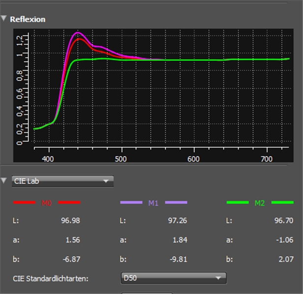

And here is the spectrum of the Canon PT101 paper
The differences are obvious - the red and magenta lines - M0 and M1 - jump far above the level of 1 - up to 1.25 which indicates a strong conversion of UV light to a blue visible light by the optical brighteners.
I have tested and profiled quite a lot of papers and can say that this Canon paper comes with the most OBA's and the HP papers CR674/672A have the smallest amount of them, all other papers are somewhere in between. (I'm not talking about some FineArt or other types of specialty papers - Baryta - Cotton Rag etc , some come as well with OBA's and other papers don't but that's expensive niche papers I'm not dealing with very much).

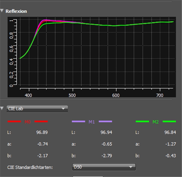

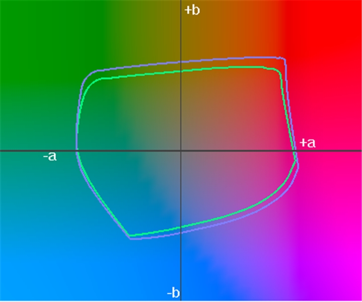

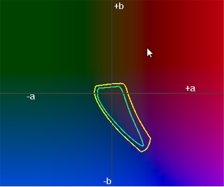

I compared as well the gamuts of these papers at L=50 and L=20 , the green line is for the CR672A paper, this one has a slightly smaller gamut across the luminance range , not much but measurable so these 2 papers to not have exactly the same coating but will overall deliver the same look of prints
View attachment 14397 View attachment 14398

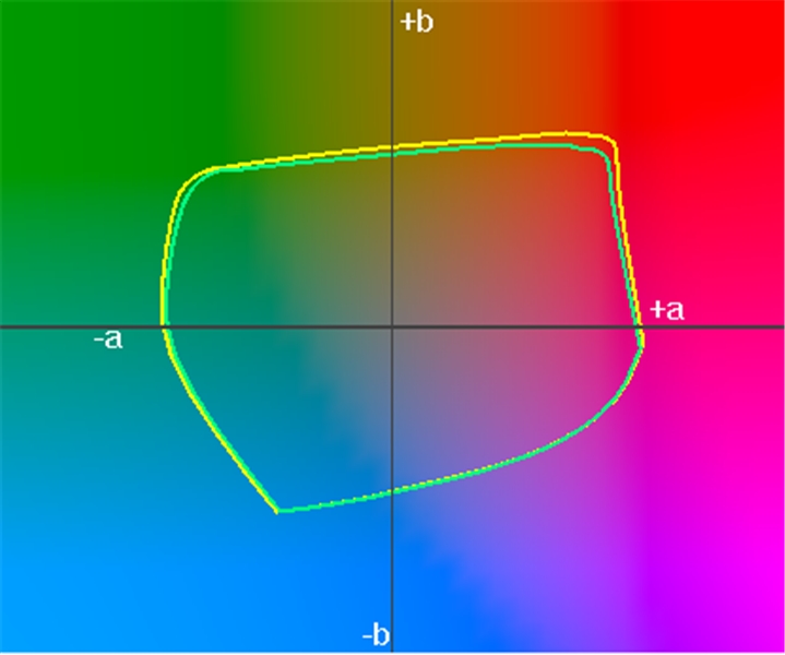

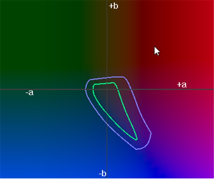

Here is a comparison between the CR672A and the Canon PT101 with the blue line, the Canon paper overall exhibits a wider gamut, specifically at lower luminance levels, this overall gives better detail definition in darker image areas (if your image has such details in the first place)
View attachment 14400View attachment 14399

You see in my diagrams the M2 curve - the reflection without OBA activation runs at about 95 to 97 % for most papers , a paper is not a mirror so you don't ever get 100% , and every reflection increase above 100% is caused by an OBA in the M0 curve, and your diagram of the PT101 paper matches exactly the level in my diagram , the M0 curve is typically slightly lower than the M1 curve but that doesn't matter for this OBA evaluation. You can test different papers, and you can measure the reflection curve before and after a fading test - and you'll see that OBA's fade as well.

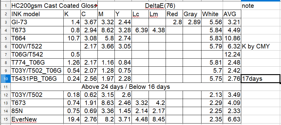

T5431+T06G(T502) seems like read error, update new chart read.
The T673 M seems very weak on Glossy paper, but K performs pretty well .
T00V(T522) seems like not so bad on CMY, but I need another test to check about the K. From EPSON Inkjet paper(matte) , it's as worst as T664 K.
After another 10 days.
EPSON Inkjet Paper(Matte)
200gsm Cast Coated Glossy Paper
180gsm Glossy paper
Based on above results, T673 seem ok to me.
For 4 color dye printer, I would use T673K + T502 CMY for mostly glossy paper usage.
But if main target is matte paper, maybe change to T673M since the M from T502 seems fade faster on matte paper.
In my region, no 106 ink available. T673(13USD) a little expensive than T502(10USD).
The HongSam EverNew K & M seems fade fast, especially the K. Seems similar change to blue/green as T522 & T664 on Glossy paper.
