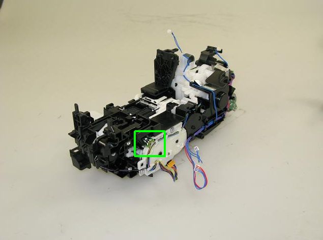

I thought mistakenly the printer was an MP499 due to the thread headline. I have an MP620 and the parts catalog and service manual.
I viewed your video clip and noticed a flapping noise at 0:29-0:36. My MP620 does not make a such noise at start up, so I think that noise is related to the purge unit error. Maybe something is blocked?
Here is a photo of the purge unit from the service manual page 30 lower right corner. I have marked what I think might be the cam position sensor. :

Hello PeterBj,
I tried to clean all the Sensor IR and set up everything again...Hopeless...
Still the same error msg.
No idea from where it's coming from.
