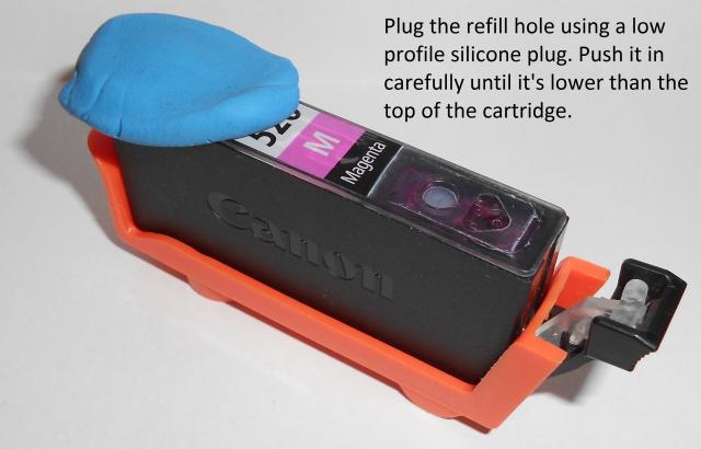

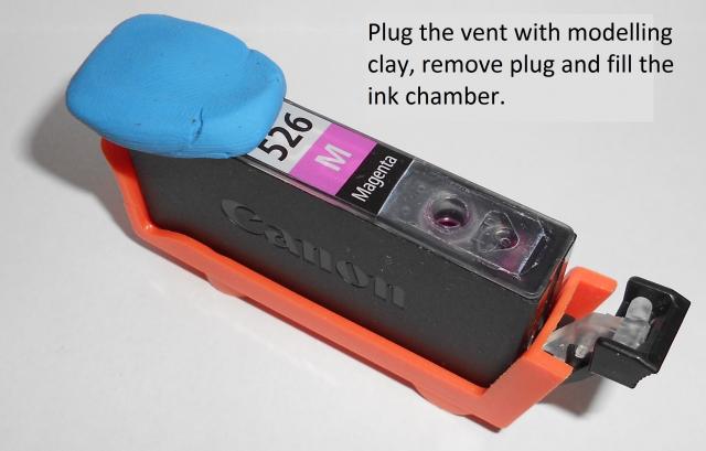

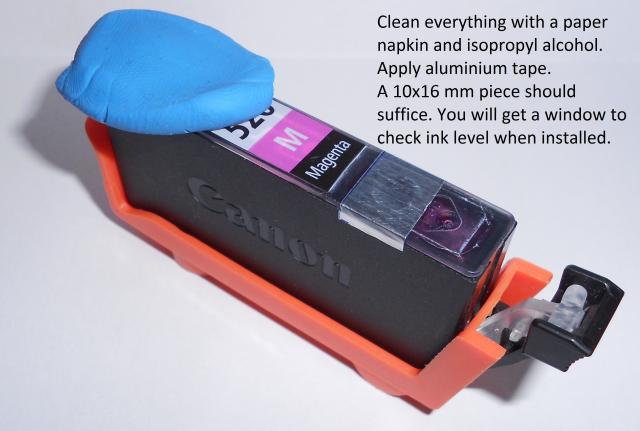

Tudor said:
@lin:
The idea was to not overfill the sponge. If you read the writing on the pictures you will find these steps:
a. Close the vent with the clay;
b. Unplug the refill hole (if plugged), fill the ink chamber and plug it;
c. Remove the clay and wait 2 minutes for the sponge to absorb as much ink as it needs. You can wait longer, but 2 minutes should be enough.
If needed you can repeat steps b and c until the cartridge reaches a weight of 20-20.5 gr.

Here are the pictures that followed 1.e. in my original first post. 1a, 2a,b and 3a-e were added at a later date. It may help anyone interested in understanding the discussion that followed.

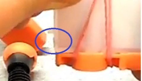

Tudor, By the way, out of curiosity I wanted to asked, in your video posted in #41, is there a german refill method refill hole at the front of the cartridge (where the sponge chamber is. where the refill hole is near to the cartridge plastic front tab is)?
Have you used this cart in your video for german refill before where there is a front refill hole?
The reason I asked because I saw in your video. And I wanted to understand what was the condition of the cartridge like apart from it being flashed and dry with paper towel for 2hrs hence not bone dry.
Tudor
May 6, 2011
505
203
Cluj-Napoca, Romania
Epson L800, 1400; ML-2165W
Yes, there was a hole for the german refill method. I filled that hole with hot glue and you can see there is a small disc of glue on the outside.
If this, in any way, nullifies the experiment please tell me before I start another video.
Okay, thanks for the info.
I am not familiar with german refill method. But since anyway, you have sealed that german refill method front refill hole with hot glue so I don't think it should in anyway nullifies the experiment or the video I wishes to capture the process and download.
