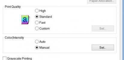

Can I mix bulk yellow and magenta dye ink from the same manufacturer?
Firstly, yes you can mix your colour inks together without causing any harm to your printer, no separating or clogs issues will occur.
But if you mix the yellow/magenta colours together, you’ll get a completely different outcome, that will then affect all the other colours too, and you’ll never get satisfactory colours again.
The compatible colour spectrum is different to OEM inks but are used as a complete set, so you can’t just change 1 colour, the best way to overcome this is to use the printer preferences / manual Colour Adjustment and that will make a big difference to your output…
Capture22.JPG Capture21.JPG click to enlarge..
