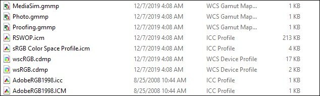

@Ink stained Fingers - you are right that the AdobeRGB is a color space and not a printer profile. But the question here is that Canon claims its printers can print sRGB and AdobeRGB color gamut images, and there are settings for it in the driver, which are enabled or disabled based on the ICM files available for the driver to use.
@Roberto Smith , I do have them installed at the right places. The fact that it still doesnt show up probably means that for my printer iP8720, there is no option for it to be enabled. Or that my printer cannot print images of AdobeRGB color gamut and can only do sRGB.
Maybe as a last try, could you take a snapshot like I did of the rgb profiles from your folder?
"C : \Windows\System32\spool\drivers\color"
There's lots of files in this folder on my PC, however in the "Input Profile" in the Printer Driver there are only two options: Standard and AdobeRGB(1998).
"@Roberto Smith , I do have them installed at the right places. The fact that it still doesnt show up probably means that for my printer iP8720, there is no option for it to be enabled. Or that my printer cannot print images of AdobeRGB color gamut and can only do sRGB."
This is basically the issue I was having for ages and then it suddenly appeared in the Input Profile drop-down menu. I followed Canon's guidance to the letter and it didn't work. I rang their tech support and even they couldn't tell me why it wasn't working or how to fix it. I just checked it one day and there it was.
