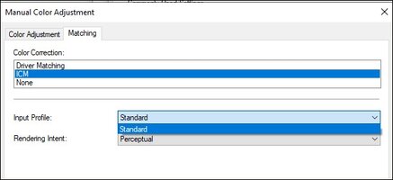

yes @Roberto Smith summarized it correct. I cannot get AdobeRGB option to show up on my native printer driver settings. You can compare this attached image to what he has. You can see that the dropdown doesnt have adobeRGB as an option, even after following Canon's recommended steps of installing the icc profiles from Adobe (yes we can continue to discuss whether its a color space or a profile, but thats beside the point).

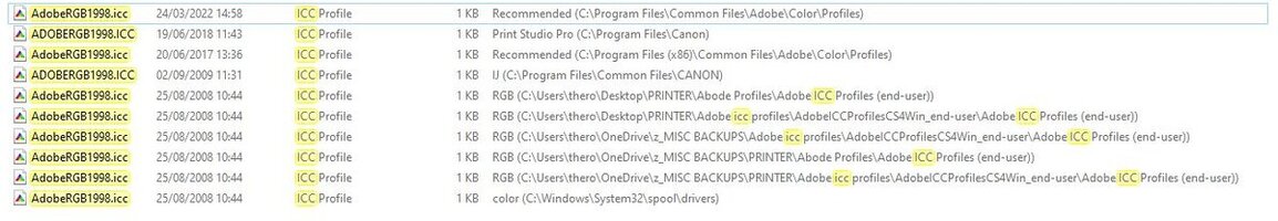

If you figure it out be sure to let me know how you did it. If I ever need to set mine up again I don't want to spend another three months figuring it out. If it helps this is the all the locations of the file "AdobeRGB1998.icc" on my C drive. Quite a few of these definitely won't be relevant but one of them might be what made it work in the end. I seem to remember all I was doing was constantly installing it (right-click file and selecting "install profile") and when that didn't work just copying the file over from one location to another (I think I was copying it to the system32\spool\drivers folder but can't be sure).
Again I know a .icc profile isn't a colour space but for some reason it seems like it can be made to act like one when using it as the Input Profile on a Canon printer. Canon told me it's basically a colour correction method and makes the printer output out in a wider colour gamut than sRGB without needing to specify it in a particular piece of software.

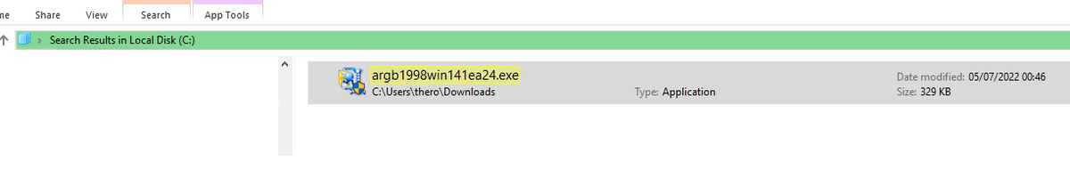

@Roberto Smith Yes, that is infact the way ! Thanks a ton.
Well, now you know too. Install the icc profile, and then install the patch for adobeRGB.
