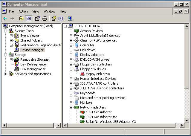

Step 6... You should now be able click the shortcut on the desktop, have a new window open and be able to type targen -? at the command prompt, press enter and be rewarded with a long list of options. Make sure you have your colorimeter plugged into a USB port and you should also be able to see, if you have your USB colorimeter installed:
Argyll..... in the list, in 'My Computer, Right Click->Manage->Device Manager list of devices.
