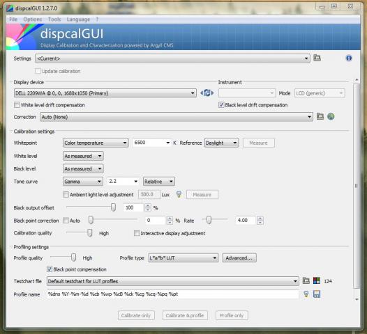

Need some help installing DispcalGUI and Argyll
Is there an easy instruction site anywhere on the web. I don`t miond struggling along, as long as I am following the correct information.
I think my problem is the USB driver for my colormunki is not being recognised by Argyll.
Have tried to follow the cryptic general instructions, but does not seem to work.
Hopefully, I have attached a screen shot to this post, showing what I get when I open the program. Seems OK except the bottom three selection boxes are greyed out.
If you don`t see the screenshot then I botched the upload.

I'm using Linux, but maybe this little piece of info will help you. Argyll needs it's own driver, it can't use the one that comes with the colormunki software. Maybe look in the device manager to see which driver is being used.
