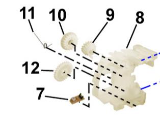

One last request for you (as if you haven't provided enough already) or anyone else here who's ever taken apart a Pixma MP. I just got Canon to send me a release arm (see above), because search high and low, I could not find a second one that fell out anywhere. Anyway, another part fell out, too, and I can see it in my service manual, but the drawings are so bad, I can't tell how exactly it's supposed to go back in. It's a torsion spring (the kind with two arms that push out, and one arm's longer than the other), part number QC2-0039-000.
The part is labeled 11 in this diagram. The only thing I can see to do with it, offhand, is pictured below (circled in red, picture taken from the side of the printer where the purge unit sits - that's the printhead motor just behind the spring). But I can't see what purpose it's serving in that position.

Wow, I'm amazed there's something you don't know about these printers. Thanks for letting me know, though. If anyone here has opened their printer up and see's how that spring is supposed to be placed, please let me know.
