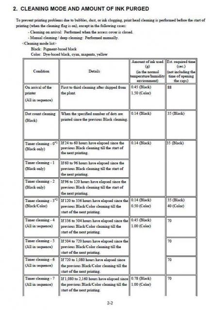

I think that someone is missing the point of the post. The object is to refill the ink,... and to have the Canon ink monitor keep track of the level. No matter if the power is on or off if you remove and ink cart and refill it (AND RESET IT SO IT SHOW FULL) the printer will detect this and even if you only changed one ink cart the printer "BELIEVES THAT A BRAND NEW INK CART" has been installed. That will alert the logic board and a full cleaning cycle will take place. The only way to defeat this function is to continue to refill the ink carts and ignore the Canon ink monitor and to do that you have to "Disable the Ink monitor function" However I still don't believe that this will shut down the automatic cleaning cycles that are part of the basic design and monitor how long it has been since you last printed. Cleaning when you change a cart is insignificant compaired to the cleaning cycles based on daily usage.
In the newer Canon printers they have not defined in the Service Manual exactly what "Timings" are used to initiate a cleaning cycle. They did this for all earlier printers. However I know that the printer is still doing the process,..they have just decided they don't really need to tell anyone about how, when, and why. Here is the example from the iP4200 printer.
These two charts show the times, the amount of ink dumpted, and the specific conditions. You will notice that It is done after every cartridge change.

That's a whopping amount of ink, and it explains the outrageous ink use.
It looks like if you print black and white every 2 days and color every 4 days you can beat the purges. And maybe, if you can refill without changing cartridges, you can again beat the purges then too.
One interesting thing is that it looks like you could beat the excessive ink use even with OEM ink.
