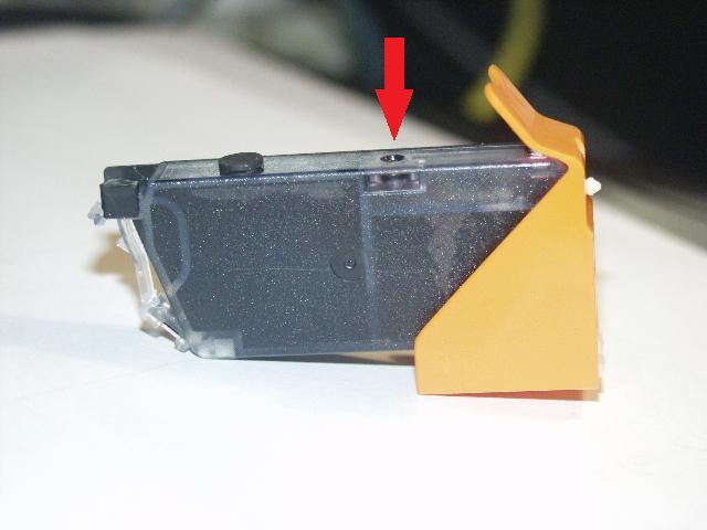

have been having a closer look at the jet tec black that is presently not installed in my mg5250
the airway is uniquely situated in the front of the cart and testing with a pin proved it not to be a
simple through hole, but one that turned at right angles and went down the front of the cart.
there is a dividing wall that creates an upright chamber at the front of the cart through which the
air seems to flow. i have never seen ink enter this space unlike the maze system that canon use
which floods up through the maze if you overfill.
there is more than first meets the eye to these carts and i think jet tec have
done a fair amount of research and design on this cart.
i am unable to tell if there is one or two foams contained within the front section,
but all in all i think its quite impressive. whether it is as good as the oem remains to
be seen but this is not one of your cheaply produced compatibles that abound on the market.
postscript:
just taken another close look at the cart using a strong flashlight, the ink absorbtion in the foam
has a definite horizontal line about 10mm from the bottom. not wavy dead straight which to me suggests it
may be two different foams with the bottom one showing darker by being more absorbent.

Looks good at first sight.
Third party manufacturer has to make other designs not (only) for better solutions but mainly to not violate the original patents...
How do you drill the fill hole and which rubber plug do you use?
PS: There seems to be no chance to puncture and fill it the "german way"??

Isn't that a plugged fill hole on the left of the cart? Orange plug.
How do you drill the fill hole and which rubber plug do you use?.....................
The orange plug on the top is where i drilled a fill hole for top fill method. i dont have any problem with top fill method. the plug is from a jet tec kit but now i use octoinkjet ink and their plugs. they have to be low profile plugs so as to clear the printer internals when the carrier goes to park position. i used a little hand held drill from the jet tec kit then another drill just to size it out for a snug fit on the plug, not too tight but not loose either.
see here for more pics. http://www.nifty-stuff.com/forum/viewtopic.php?pid=60355#p60355

pixmania, what about the top-middle hole? Is it the factory fill hole?
