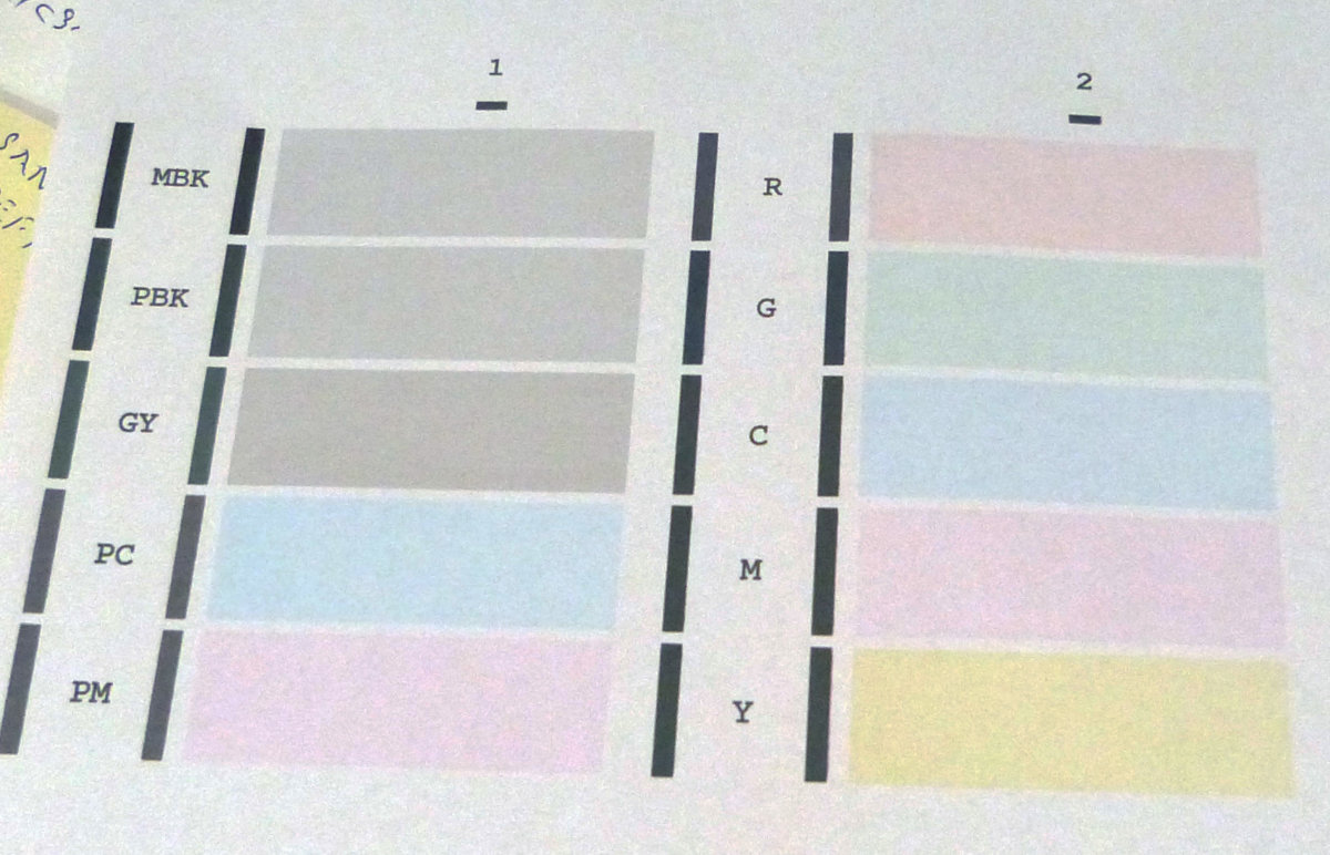

I got a chance to print a lot of work on my 9500 mk2 printer today, it hasn’t been on for more than 3 months and I want to see how much ink it would waste after such a long period of idleness. (Un plugged from the wall)
I turned it on and nothing happened, no purge, I then ran the Ink Quality Maintenance to start (Agitation) followed by a nozzle check and finally it did it's first ink purge. (Nozzle check perfect)
View attachment 7668 click to enlarge.
I had several different types of printing to do and on the 2nd and 4th print the printer ran two other ink purges, I must have printed more than two dozen sheets in two hours and when I was finished I used the Power Off Utility in the Printer Maintenance panel, and the printer ended with another purge.
When I got the chance, I emptied the Printer Potty and weight the waste ink that had accumulated from all the ten cartridges over the two hours, in all the time the printer was powered on it did 4 ink purges and 1 vacuum purge.
The total waste came to 9.5 grams, so to put that into plain English, the printer wasted 1ml of ink for each cartridge, now if that doesn’t convince the sceptics I don’t know what will, because the printer had been idle for more than 2000 hours, and that’s a darn sight more than 60 hours.
Is this 60-hour massive ink waste thing a Myth or is it real, because I can’t reproduce it if it is, and I spent the whole time carefully scrutinising my printer from start to finish and recorded everything it did...
