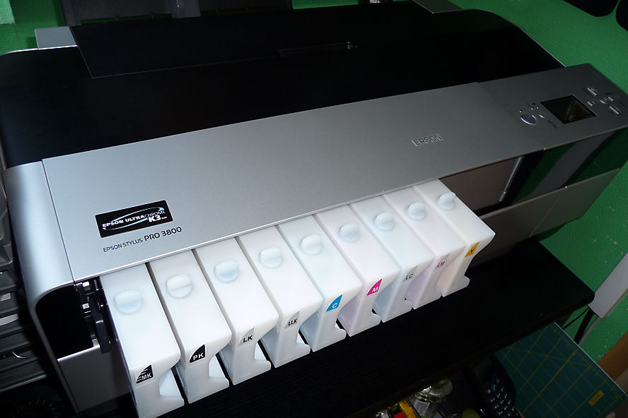

Hi avpman,

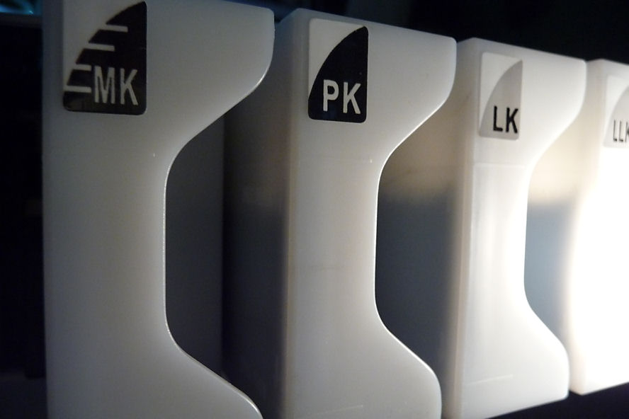

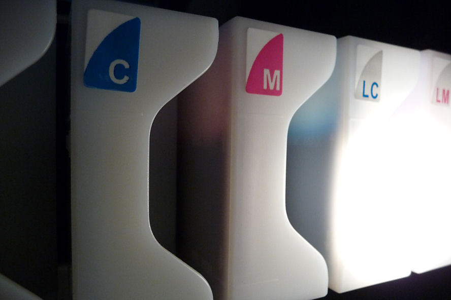

Concerning the resetting: I am not so happy too with the reset all cartridge at a time, would be better if the system was capable only the cartridge which is registered as empty by the system and only refill that system. But your concern about the ink level not visible by the stains: I swirl the photo black cartridge a bit and after letting it stand for a few minutes it was very easy to see the ink level using a torch shining trough the material, so it is possible to see the ink level.
Here is the proof:
and here:
with the last picture you can see that even if the cartridge wall is stained with ink (magenta and Light Cyan) you can still determine the actual ink level, because this is much darker. It would however much better if there is some transparant window built-in, but I think this will reduce stability of the cartridge.

The final result: a very neat printer with the Inkrepublic.com I-refill system and no problem with the cover anymore.

Agreed. But unfortunately this still involves removing the cartridge. The constant removal (for resetting) and checking ink levels is their Achilles heal because the ink outlet port seal will degrade. Also, if you have to keep "topping off" the ink levels in the cartridges you'll never run all the ink out and it will eventually go stale.
