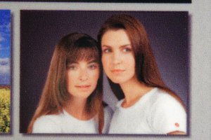

I did another test to compare printouts and to see whether and which differences might be visible , I printed the Fujifilm test image on the ET-8550, the L1800 with 6 inks and a WF-2010W with 3 or 4 inks.
I'm printing this image with the Epson native resolution of 720 dpi for these printers which results in a print size of 116 x 82 mm. I'm focussing onto the small shot with the foto models which print at 17 x 11 mm and do some macro shots to get down to the pixels and droplets.
I'm printing with the high and best quality settings for the Epson Ultra Glossy - UG - paper on the ET-8550 and get these prints
I don't see much of a difference here. And this is the same print on an L1800 printer - with light links, the driver does not offer a 'best' quality option, just standard and high settings for the ultraglossy paper, this printer runs as well with 1.5 pl droplets as the ET-8550 does .
The WF-2010W runs with 4 inks in various combinations -there are printers and combos with prigment inks and models with dye inks offered by Epson, or a mix with a pigment black and dye color inks. The driver for all these models does not use the black ink - whatever it is - if you select a glossy photo paper, it is mixing the inks to get a not so black blue-violett color, it does not really look pleasant, if you use the matte or inkjet paper setting the driver uses the black ink channel and you get decent print output. The larger droplets of 3 pl are visible in the macro shots but not in regular prints, we could go down to the arcsminutes for the limit of visibility of fine details - something like 0.15 mm in 25cm distance - the actual droplets are smaller - but you see as well other numbers quoted on the internet. It does not matter much - you most likely would need glasses for close-up viewing anyway for a 25 cm viewing distance.
Since a printer like this WF-2010W does perform quite well for photo printing Epson is restricting the use of some options intentionally, the WF-2010W prints borderless, there is a piece of absorber foam at the bottom of the print mechanism to catch the overspray from borderless printing. That's fine to this point, I'm not talking about the low print speed for photo printing since there are only 3x59 nozzles for the CMY colors.
There are Ecotank variations with this print mechanism, some don't let you print borderless at all, the absorber is not there, or you just can print borderless on 10x15cm, not A4, the absorber strip has only half of the length.
And there are various ink combinations - all 4 inks are dye inks but the black is still not used for glossy paper, or some models use a pigment black and 3 dye inks or combos use 4 pigment inks like the WF-2010W and other WF.... models more tuned for home office tasks.
If you do refill or use 4 dye inks on a printer version which supports borderless on A4 - the L310 did not but the L382 did - you have a pretty good photo printer for occasional use , the graininess is not visible, and the gamut of a WF2010W is pretty close to the photo printers. But Epson would not like you to know this and rather sells higher priced 'photo printers' to you. (But again - the printing speed is slow which should be o.k. for occasional use).
I'm running a WF2010W mainly for ink testing , with a rather wide set of refill cartridges - pigment and dye - Canon - Epson - 3rd party - China etc.
The L1800 as the 1400 Ecotank A3 photo printer version uses 6 inks - with light C and M and one black ink channel only, the droplet size is as well 1.5 pl for the smallest ones. But the user does not have any control over the use of different droplet sizes via the driver, it is hidden for him.
The actual print does not look very much different to those prints from the ET-8550
