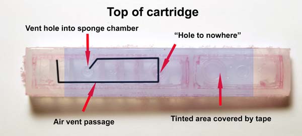

I had a dead cart that had air in the sponge, so I decided to dissect it to see what's inside. The "SpongeFilter" shot shows that the sponge is actually 3 separate pieces. The top piece is a soft "open cell" foam (you can easily blow through it). The middle piece is fairly stiff and is a "closed cell" foam (you can't blow through it) This explains why it is practically impossible to get ink back into the cells of this foam if it is allowed to become empty. The bottom part (commonly called the filter) actually is a filter - it is very similar to the filter material used on cigarettes. The "FilterDetail" is a closeup after it was pulled apart - it is composed of very small fibers that are aligned vertically to allow the ink to easily flow down to the printhead while providing a fine filtration.
The "TopDetail" shot shows that the air vent is a long, narrow passage (traced in black to make it visible). There is a "pothole" in the middle of the vent passage, but it doesn't connect into the cart. The area that is covered by the top tape is tinted; the tape forms the top cover on the air vent passage and seals the fill port.
The two "PrismDetail shots show the design of the "prism" that is used to detect an empty cart. Detail 1 is a side view, and Detail 2 is an end view of a cut through the prism (parts of the cut have been colored with a black pen to make them visible). As I understand it, a beam of light passes up on one side of the prism. When ink covers the prism, the difference in the index of refraction between the plastic and the ink reflects the light first to the side and then back down to a sensor. As the prism is uncovered, some of the light just passes straight up into the ink chamber and the sensor gets a lower signal. There is a hole in the print head directly under the prism on each cart, so there must be a single light/sensor located in a position where the head passes every cart over the sensor when the head goes offline. Detail 2 also gives a good view of the passage connecting the bottom of the ink chamber with the bottom of the sponge chamber.

Holy Cow! Great work! So I guess you're ready to start producing your own cartridges now? ;)
BTW, is this an OEM cart or a NON-OEM cart?

This is a NON-OEM cart - I don't have any dead OEM carts at this time. Maybe some else has a dead OEM cart that they would like to test - all it takes is a hacksaw.
As Neil said in his write-up at:
http://www.neilslade.com/Papers/inkjetstuff11.html
"I have found that the PHOTO CYAN and PHOTO MAGENTA colors are used up two to four times faster than any other color. On top of this, if the cartridge goes completely empty before refilling-- nine times out of 10 you are screwed and you will never be able to get that cartridge to work properly again. Why? Air inside the sponge ink filler inside the cart will block the flow of ink, and there is NOTHING you can do to remedy this once it happens except replace the cartridge."
His statement is too much of a challenge to ignore. The purpose of the dissection was to find out why this happens and to try to find a way to rescue even carts that have air in the sponges. You should understand a problem in detail if you want to fix it.
