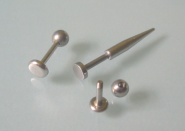

It seems the possibilities of sealing the refill hole are endless... :)
Gismo2911 from a german forum likes to replace the original canon balls with stainless threaded piercing balls. Just put the screw on the ball if you want to remove it for refilling.
