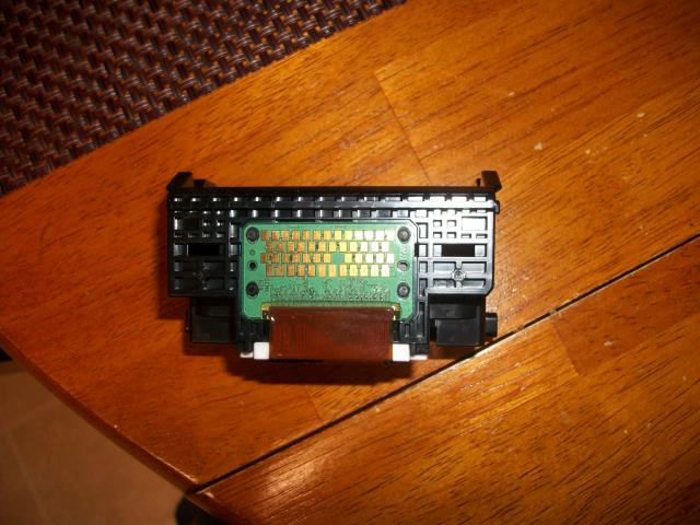

The Hat & websnail,
I will take a picture of the back of the print head and post later tomorrow evening. I have noticed that one gold metal piece is missing from the contact on the back. I am thinking that it is not by default and that may be the problem but you guys will know better when you see it. I have been using after market ink cartridges by G&G Compatible with ip4700 for a few years with no clogging issues. I was not happy with the colors though. The Hat went to a great length to help me out with that issue. Thank you for all your help again, The Hat. I was never able to resolve it and since I have the MG6220, I use that for photos and ip4700 for everyday printing and did a good job on that front.

AS you can see from the picture one square gold plate is missing in the middle. Is that by design? Could that be why I am getting the error B200 message ?

There is no way of knowing for sure if that brass contact should be there or not see one of my old print heads as an example,
yours has 4 rows of brass contacts to my 5 which is very different.
I would hazard a guess and say it wouldnt help having it missing so if you have already cleaned these contacts with a bit of alcohol
and it still doesnt work then a replacement is your only option or sadly trash the printer.. :(
5,248
5,153
I think that the missing pad never was there. Wiping a printed circuit board with alcohol doesn't make the pads come loose. It normally takes overheating with a soldering iron, for instance when attempting to desolder a component for pads to come loose. Also the surface of the PCB doesn't look to be damaged by heat or chemicals where the pad is missing.

Thank you guys. I will now weigh the pros and cons of getting a new print head for the IP4700 vs buying a new or refurbished MG6220 with a one year warranty.
