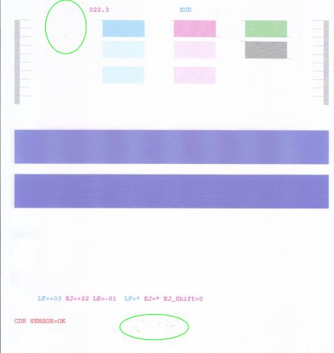

Here is a Service Test Print that might be useful for someone. TBH it doesn't mean anything to me at this stage apart from seeing that the dye inks are printing nicely. There are some curious black specks highlighted.
Thanks.

Your service print with the curious black specks is in fact the pigment black trying to print.

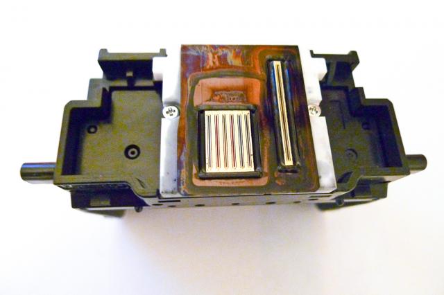

Just to add to the mix, here is a pic of the printhead.
I have noticed that the print head has quite a bit of black ink around the nozzles. Is this normal?
Thanks.
nche11
Printing Ninja
Mar 3, 2008
230
79
It is normal as long as the ink does not cover over the nozzles. The purge unit has a soft plastic wiper that wipes the print head from time to time. So the print head may have some ink on the edge.
