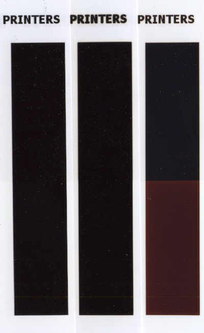

I'm running a fading test with these Chinese swellable papers, and a trend becomes visible after the first week.
The left bar is the reference print on the glossy swellable paper, kept in the dark,
the middle patch is the exposed one, the right patch uses the standard Sihl/Netbit paper to compare with. All prints are done with the same printer, the same driver settings and the same inks, in this case a mix of a Canon BCI1411 black and Epson L300 black, both inks are of the quick fade type and can deliver results within a short time. The top half of the prints are overprinted with a gloss optimizer in a 2nd print run, this will allow a judgement whether the swellable papers can do better than a GO overprint for fade protection. The bottom right section is already turning into dark brown, on the Netbit paper without further protection.
I have some more papers in the test and will report more details in a week when differences become more visible.
It is quite clear that this stuff does work WRT to fade. Now what we need to see is the effect between gas and light. Another run is required with some samples in gas tight containers...like sealed glass bottles.
