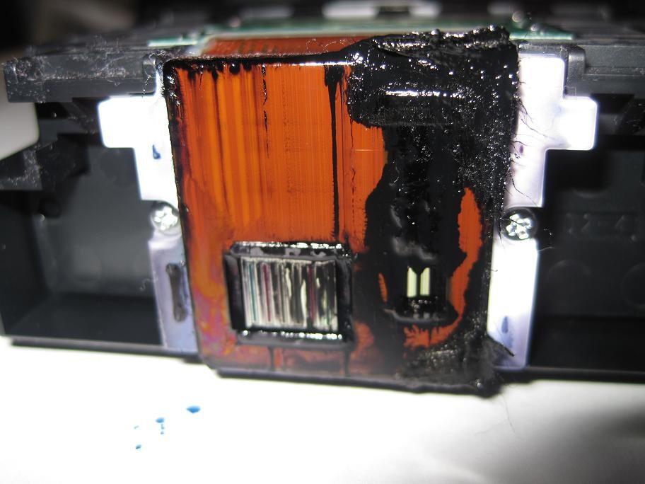

Yes, I did read Leo's post and was planning to respond to it before it got deleted. I think it got deleted because of some derogatory comment, as I remember being shocked by it, even after Rob gave a strict warning. Now to answer your concerns:
I had supplied refilled Canon OEM cartridges for about ten MP780 printers and a couple MP760s. This involved over two hundred cartridges. Over several years, I purchased Inktec pigment black ink in a pair of 1 liter bottles at least three different times for a total of six liters. Each liter refilled about 35 cartridges. Leo's suggestion that it was caused by leaky cartridges is just not tenable. He may have thought that because of the thick deposit of ink on the bottom of the print head thinking that if the purge unit was clogged, then how could the ink have gotten there but he may not have realized that during purging, the print head also fires the nozzles and this will cause a build up of ink on the purge pad if the purge pump is not sucking the ink away. Maybe you can explain how this build up could have been caused by a leaky cartridge. It doesn't make any sense to me.
I remember Leo also suggesting that used printers had an unknown history, but the MP760 that I took the pictures of was purchased new by my friend at the same time I purchased mine new. All the MP780s were purchased used.
The purge pump tubing was clogged and the waste pads were full of thick, gunky ink at the bottom. How would a leaky cartridge have caused those problems? On my printer, I deposited way more Windex than what a leaky cartridge would have deposited and the purge pump just sucked it all away. If there were a leaky cartridge, the purge pump could have sucked away the residual ink or it would have flowed off the purge pad into the surrounding area but it would not have built up on the purge pad and under the print head like it did on my friend's printer. The reason that only his printer had the build up is because he did not use Windex on his purge pads like I told all my other friends to do. Actually, I still have not taken apart all the other printers that I had to replace because of this problem, maybe I'll see some more incriminating evidence when, and if, I do.

On your picture of the dirty print head that was covered with black ink.
I had see that before with someone who printed mostly text set to high quality mode on plain paper using OEM black.
That's one of the reasons way I only recommend using normal quality mode printing text..

Ghwellsjr, I have been a member of a chip design team. There is a concept that a design by a person is not debugged by the same person. Rather it is better debugged by another person who is not necessary a chip designer. Your thread is like a design by you and everyone else either enjoys your design or debug it on the other point of view.
Your lengthy posts reveals that you have been focusing on your ideas of your design. When Leo challenged it your responses were on the same focus again and again. Just now your, basically the same focus, lengthy reply is the same as before. I have seen people thinking "ADD" in mind but actually had "AND" when did the code. He could never found such bug in his code. But a 3rd party individual could spot it in one quick look. You have been focused on the same ideas about the ink. Leo saw something else. I also can see something that you probably have overlooked.
Let's see the picture you posted here:
http://www.nifty-stuff.com/forum/uploads/1315_clogged_print_head_mp760.jpg
I agree with Leo's observation on this picture, which is worth further analysis. A normal print head receiving ink from a functionally correct ink cartridge should be free of ink on the print head surface. Your picture showed a very serious problem of the ink supply. You mentioned that the printer used refilled cartridges from you. I think Leo interpreted it that the cartridge leaked badly or something like that. Thank about it. If the print head was clogged there should have no or little ink going through the print head. There should not have been so much ink on the print head surface. The fact there was so much ink there the cartridge must have leaked badly.
Before you begin to dispute with this observation I have been refilling Canon printers since HP was selling ThinkJet in the late 80's. I have had such leaked cartridge on many printers before and have seen many of such massive leaks. In your original thread you seemed to not investigate the cause of this massive amount of ink dried up on the print head surface. I believe you went on to focus on the purge unit being clogged by so much dried ink the leaked into it. It's quite nature that because the printer used the cartridges refilled by you so you never thought that the cartridges could go wrong. You then focused on the clogged purge unit. This is exactly like a designer not able to see the "AND" he coded because he thinks he is doing "ADD" in his code.
The dirty print head in your picture is showing that you have a massive leaking from the cartridge. You can remove your print head any time to check out the print head surface. If the printer is in good working order the surface is almost always dry and clean. Let's establish a common ground. Do you agree that the picture is showing leak from the cartridges? If you don't then the dispute will go on forever. You will repeat your lengthy post again when someone else challenged it.

Now the printer with the dirty print head had a very messy (purge pad area) black ink all over the place.
When the pads were given a bit of a clean and the owner of the printer then printed his text in normal mode the problem never occurred again (18 months ago).
You are the second person today that thought the clogging that I have been talking about was in the print head. Where did you get that idea?
You have to understand that the printer that this picture was from was maybe the sixth or seventh printer that had the purge system clogging problem. It was several months after the others had developed the problem and none of them had a clogged print head. Several of them were still working and printing correctly but their purge systems were not working correctly. In fact, while I was trying to diagnose the problem, I would prime a print head in one printer and move it to a printer that previously would not print at all (because the purge system was not working) and it would work correctly there for awhile. There was no problem with clogged print heads.
You should also be aware that I vacuum refilled only Canon OEM cartridges. Canon OEM cartridges have a reputation for not leaking. If I had top filled them and had a leaky plug, then there is a possibility that they could have leaked. But vacuum refilling does not compromise the cartridge in any way. Also, when a cartridge leaks, the entire contents of the cartridge leaks out and this was not the case with any of the printers that had the problem. In my early days of printing, I started with G&G cartridges and when a brand new one of those leaked, I had cyan ink all over the inside of my printer. A leaky cartridge is quite obvious.
But I want to understand your leaky cartridge theory and I have asked you to explain why this would lead to a clogged purge pad, clogged purge pump tubing and clogged waste ink pads and you have not done so. I would like to understand what you think happened. Please explain in detail.
