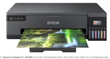

This new L18050/ET-8050 runs with the classical light dye inks LM and LC and which are bottled. It is not clear at this time how similar these inks perform in comparison to the Claria inks of the ET8550 and ET7750 which don't use these light inks but since it is an higher end printer in the Epson model range I very much would assume that these inks are good performing inks as well. This would help users looking for genuine bottled Epson light inks but are reluctant to dilute the existing M and C inks with a solvent as described already.
