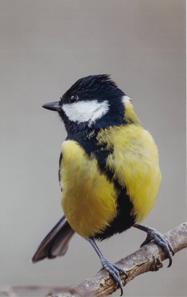

Fellows, I have a problem:
In the grey background above the birds head you can see horizontal bands.
On high quality it is less but still visible.
Strange enough on the cheap Action paper with Hagaki settings everything is OK.
So I don't think it is a paper transport problem.
Any ideas ?

The ink flow is my concern too, but I wonder why it always occurs on the same place.
I do stress tests with every ink.
By lightening the grey background a bit the banding disappeared.
Interaction with CO, in general a temporary "slippery" condition of the ink can't be ruled out.

it’s a software related issue, either from the driver or the program that you use to edit/print. If it’s not visible with hagaki paper setting, that seems to leave the driver as the most likely culprit ?
I also reckon that’s the mostly cause, think about it, same ink, same image, different surface, the only change is the driver software..
I did some new tests (plain paper M, Y, R) in Platinum N standard.
Could see one slight band in the R.
Disappeared in Glossy II settings (but the colour was a tad less bright red too).
Also the band was darker, not suggesting a lack of ink.
Driver settings seem to be very important.
