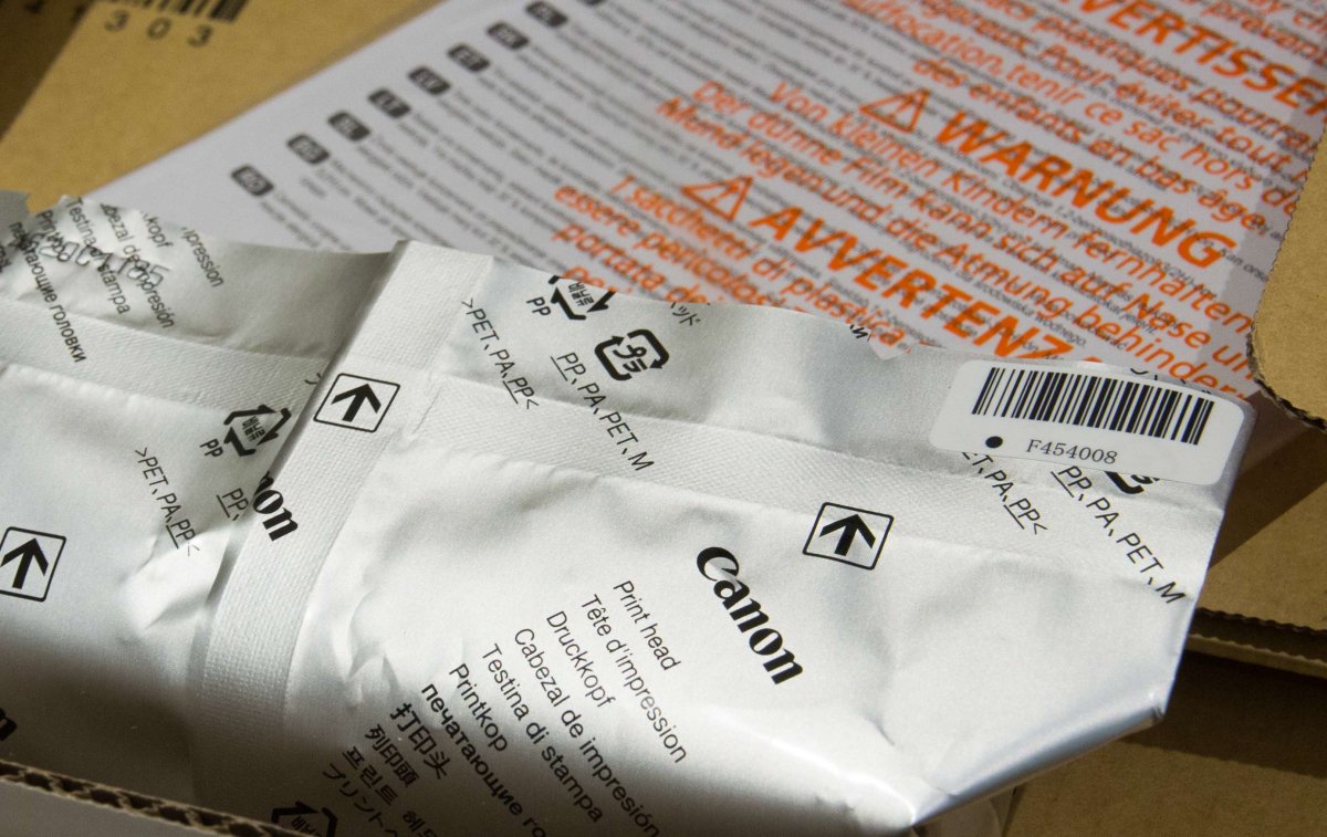

Guys, when you look at the photo of the sealed printhead bag in Keith's (as always) very detailed article
http://www.northlight-images.co.uk/setting-up-your-new-pro-300/
as far as I can see (on the small sticker on the right) it is Canon part number F454008 and that's a QY6-0085 ;)
(I double checked with my spare)
in that case @mikling guessed right
The PRO-300 uses the same printhead as the PRO-10
Many thanks Keith !

As @mikling told Sunday evening this printhead is very sturdy, in 6 or 7 years he knows of one customer who had to replace it because he didn't fill enough ink in the carts.
Worries based on experiences with the PRO-9500(II) seem to be overdone.
In hindsight hoarding 9500's was a bad idea, the successor was better as I discovered rather late.
So I won't stock PRO-10's.
Spare printheads will stay available for many years.
