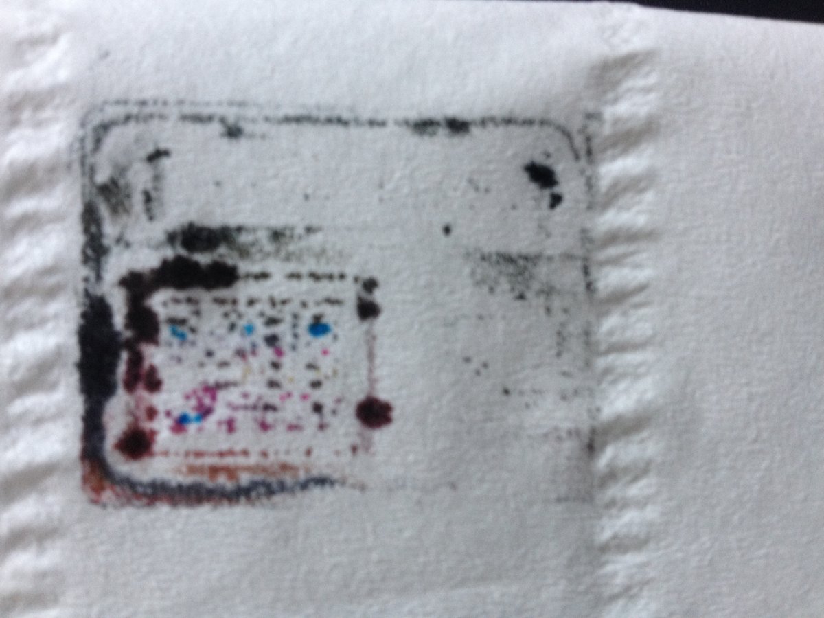

white tissue test results.
It seems that my memory is faulty. After deep cleaning the PGBK no signs on the paper. It seems a clogged head issue. Will proceed with test 2 and 3
I do not see a clear black imprint from your PGBK nozzles, only the color nozzles. There should be a long black line to the right of the color imprints. I suspect you have a head clog.
