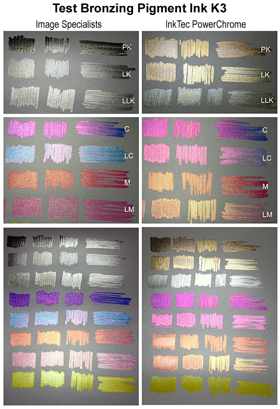

InkTec ink PowerChrome I tested a year ago. Here is a test for bronzing on photo paper Ilford Smoth Pearl. In this test, I was very disappointed. In the Czech Republic, InkTec at a good price - (1L: 1.270,- Kc - or so 63$) http://shop.inktec.cz/422-inkousty-1l/

I'm new and don't understand the above test and what it demonstrates. Could you please post some background for us clueless but interested readers? Thanks.
There is bronzing, but do notice how much glossier the Inktec is.
Especially on the paper you are using, Image Specialists pretty much turns it to matte.
And Ilford pearl is known for not behaving really well in terms of bronzing with most inks. Try something with a deeper luster finish, like Epson premium luster and the bronzing will be (almost) totally gone with the Inktec...

You printed on the same paper using the same image but these 2 different inks and got such differing results? Very interesting.

I think the test of Hainz doesn't take into account the glossiness of and gloss differential compared to the Image Specialists inks: I have used Image Specialists inks a few years ago and despite the fantastic color rendition the problem was the lack of gloss (especially the magenta and the corresponding composite colors) and gloss differential. It is true bronzing is less compared to Inktec, but overall printing results with Inktec Powerchrome has been much more better compared to Image Specialists. What I also have discovered is the fast fading of the yellow of Image Specialists, despite being a pigment ink after one year exposing to sun light (other colors are very stable).
yes it is true that I print exclusively on SATIN photo paper (Ilford and Sihl). Gloss is definitely better with InkTec. Bronzing was bad but even on glossy photo paper. Worse than the Image Specialists.
