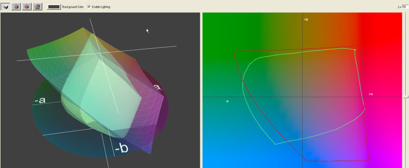

Let me just show you an example - how gamuts can match - or not , and overlap
I'm displaying here the AdobeRGB gamut and the gamut of an icm-printer profile - a L800 with 6 dye inks on a glossy paper - the gamut volume is significantly smaller than the Adobe RGB gamut but the printer gamut nevertheless exceeds the AdobeRBG color space in one area, and exactly such a mismatch can occur as well between the printer and your monitor claiming 97% of AdobeRGB
Softproofing is a very valuable process nevertheless but you just should be aware of the limitations
