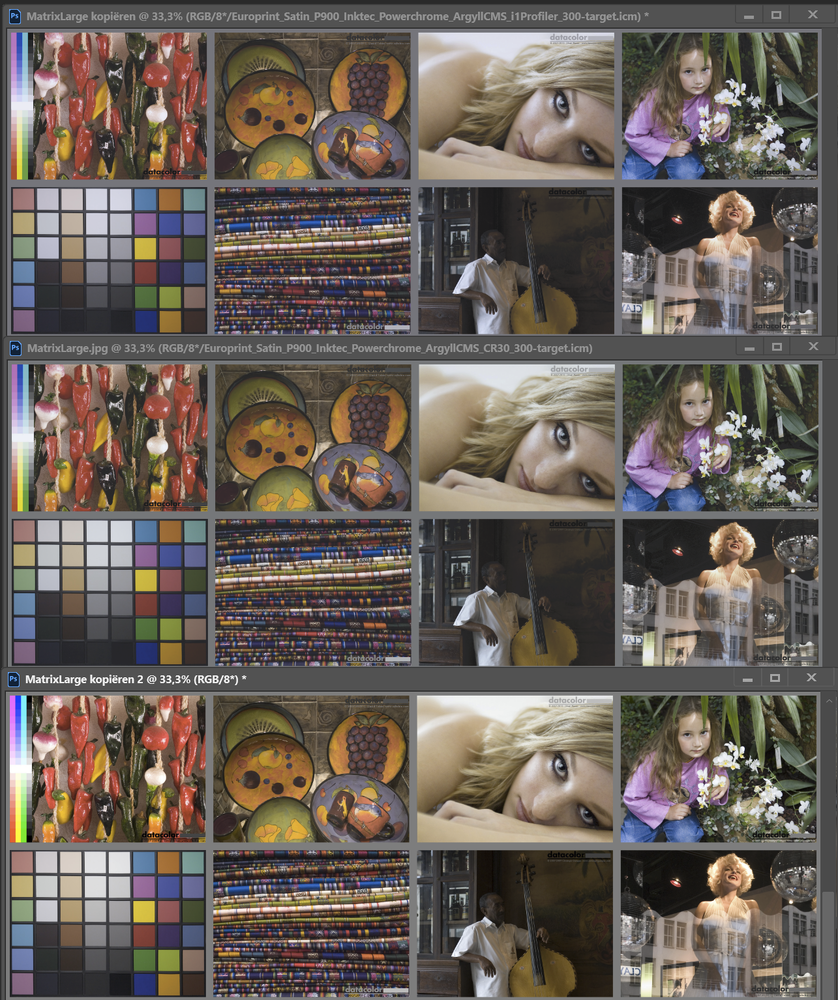

I repeated the workflow again with Europrint Satin paper with Inktec Powerchrome K3 ink in my Epson P900 using this particular 300-patch ArgyllCMS
I created a printer profile using the same target (a small one on 13x18 cm) for the i1Pro and one on A4 for the CR30 and this is the softproofing:
Top: i1Profiler
middle: CR30
bottom: no softproofing (orginal image)
You can clear see the slight warmer softproofing with the i1Profiler profile and the CR30 closer to the original image.

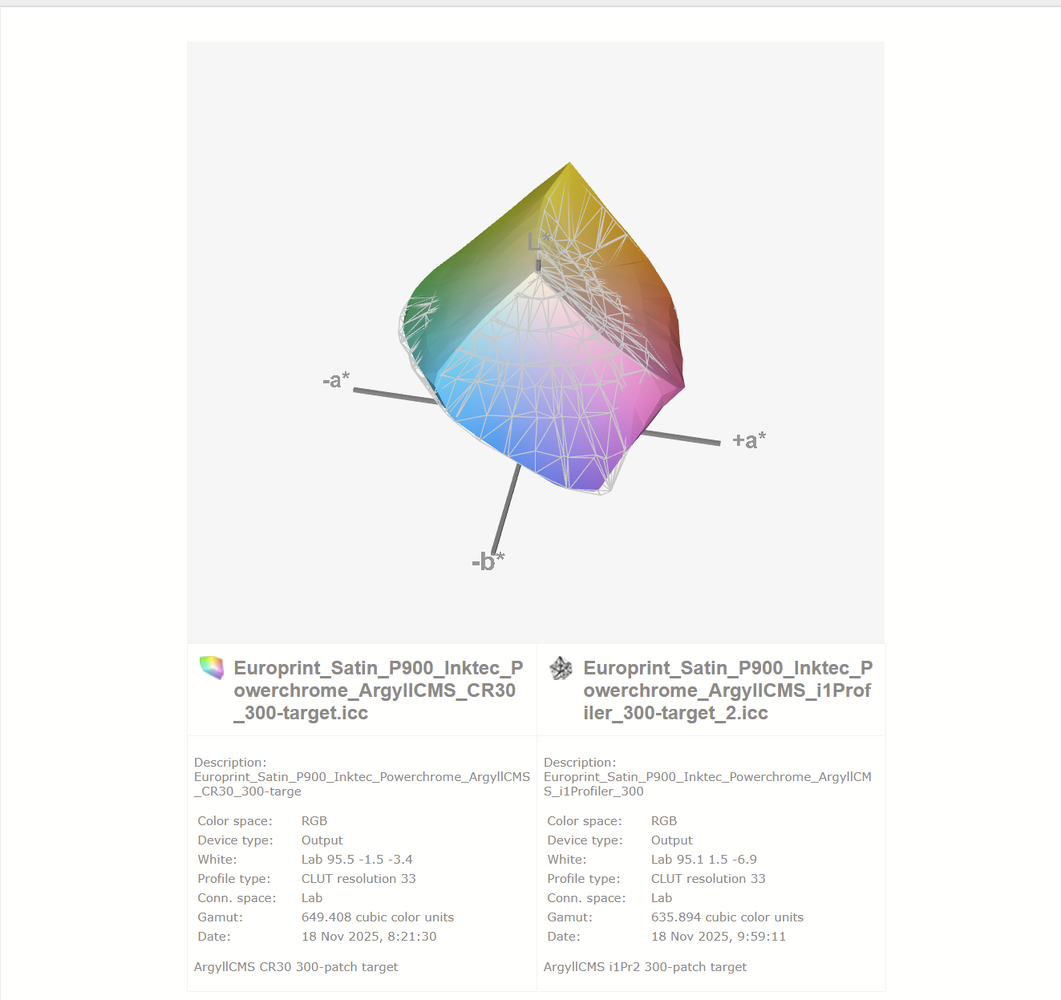

iccview.de 3D graph:
Note the white point: those are very similar using 2 different spectro's to read the same patch set.
