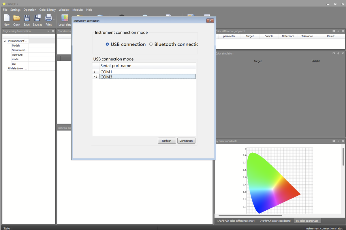

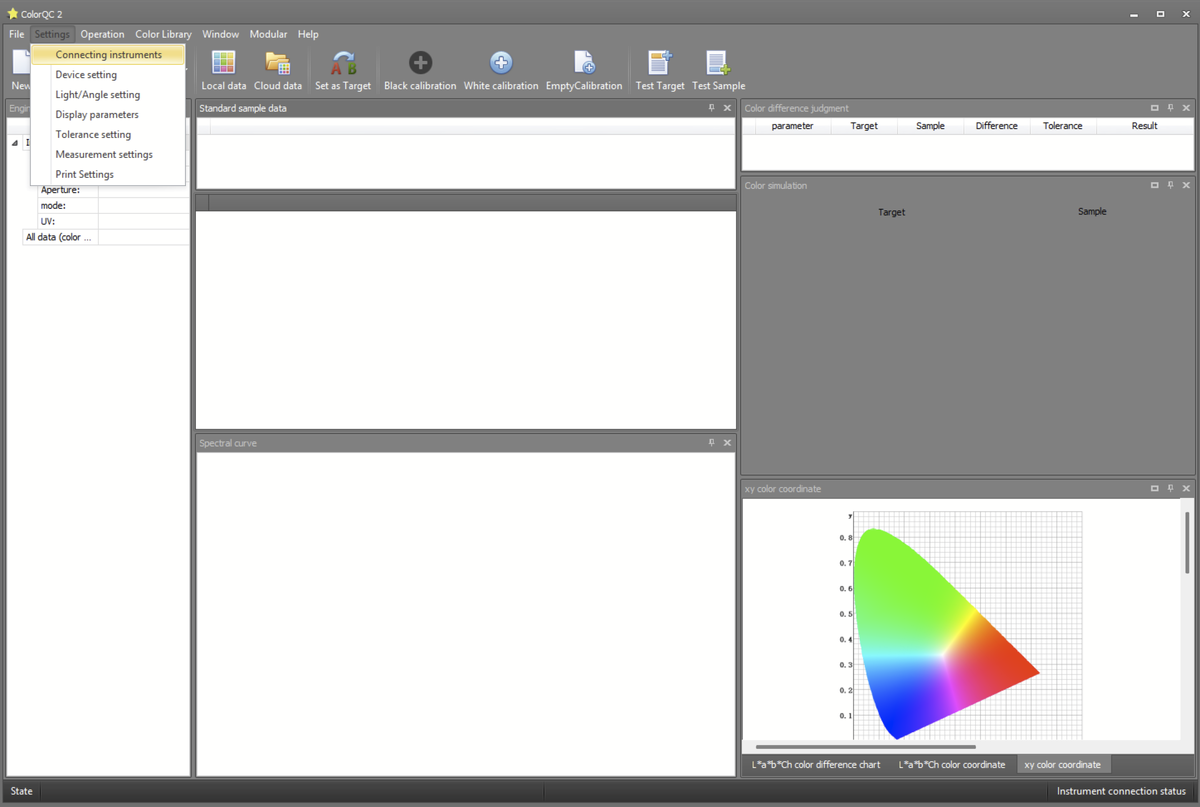

Start the ColorQC2 program and go to connecting devices (you already have connect the CR30 with a USB-C cable to your computer):
Mine is connected to COM 3, but it might differ from your configuration:

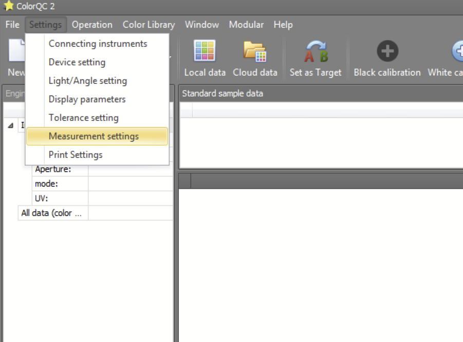

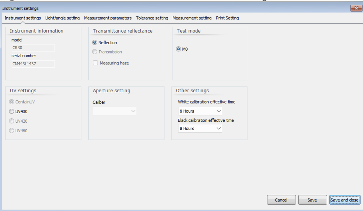

If succesful your CR30 will give a beep and then choose in the menu: measurement settings in order to setup the necessary parameters that needs to be registered in the csv-file, which is feeded towards a script that will convert it to a working ArgyllCMS ti3 file needed to create the printer profile:

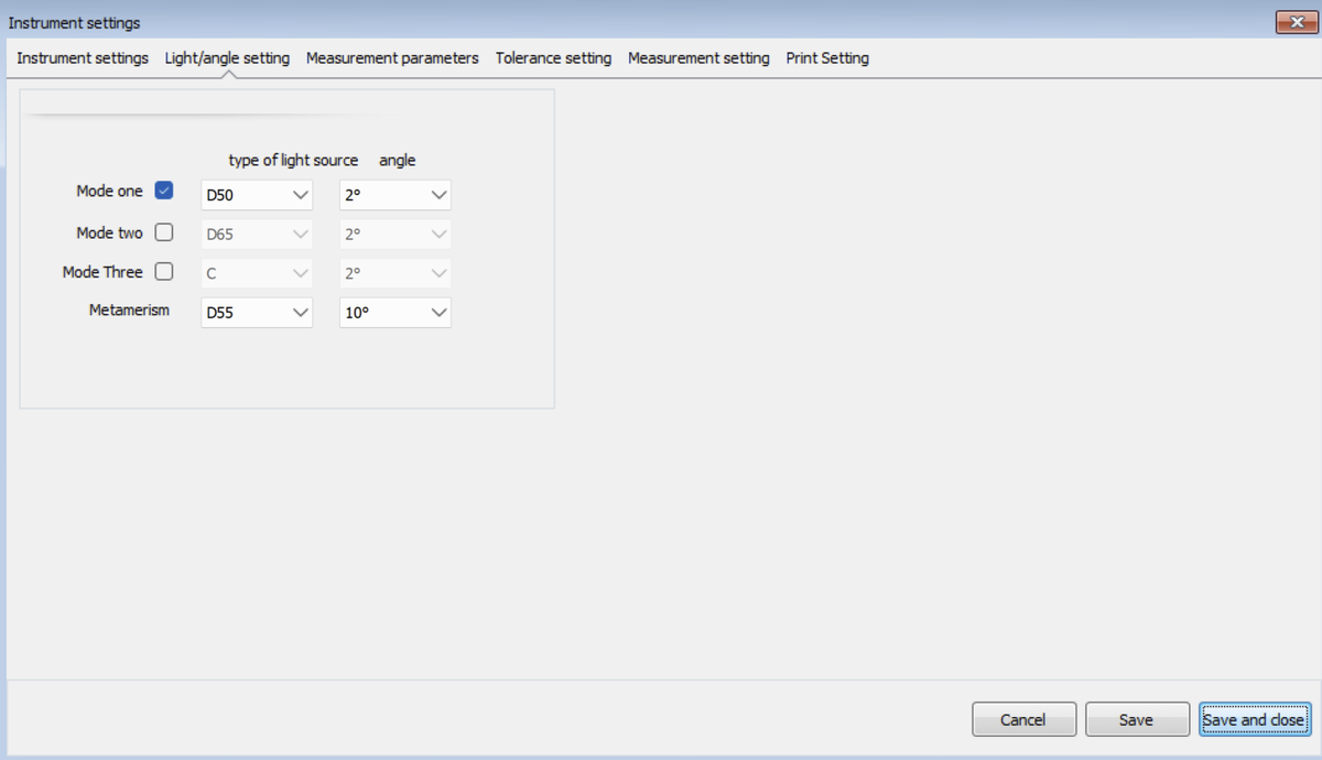

The next setting is important, as we are going to measure in the D50 mode and at 2 degrees angle (the industry standard D50/1932_2):

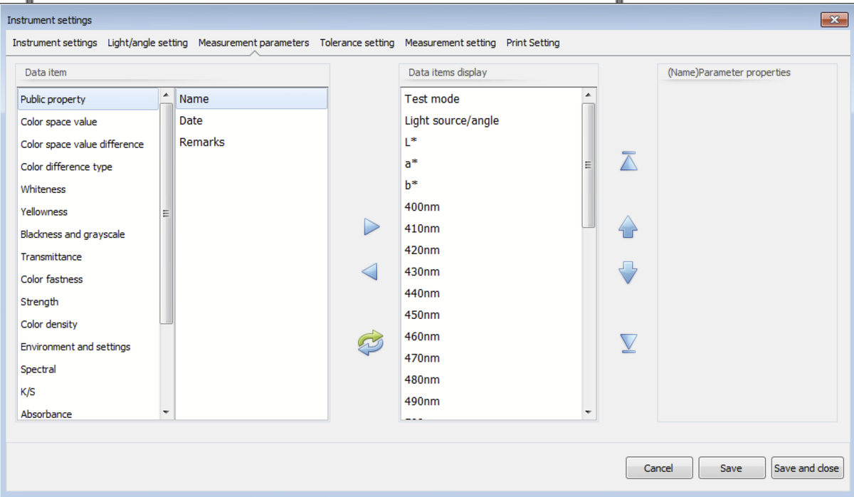

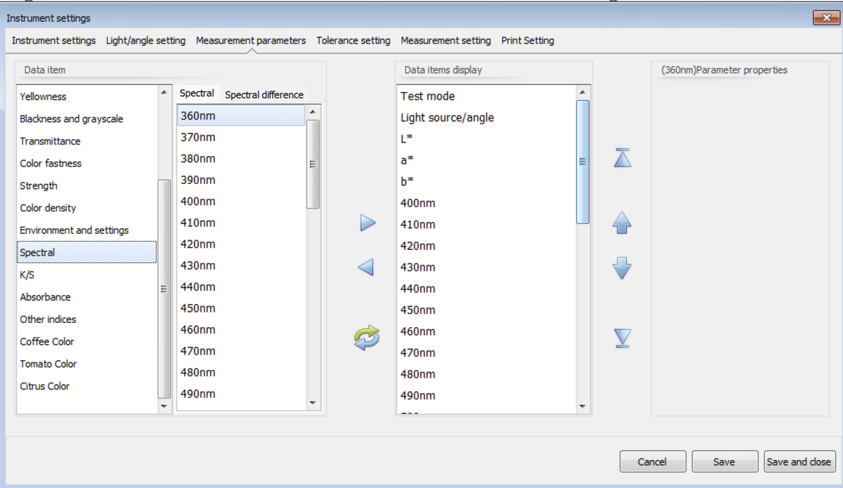

Now we are going to specify the exact data needed for the csv-file in order to generate the ti3 from from the measured data from the CR30: we will need to include the spectral data from 400 to 700 nm in 10 nm steps, so be sure all the spectral data will be registered in the csv-file. This is what you want. NOTE: to include the spectral data you will need scroll down from the first column until you see the spectral data option to be seen on the second column: choose from 400 to 700 nm to the last column and click save and close:
Above you see we will register test mode / light source+angle / L*A*B* value / spectral data from 400 to 700 nm in 10 nm steps

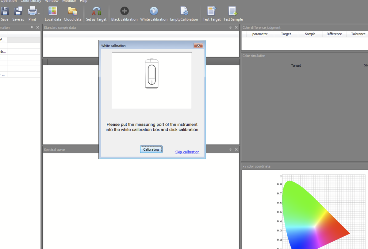

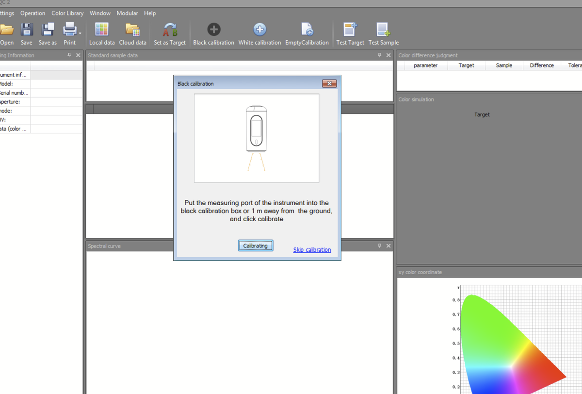

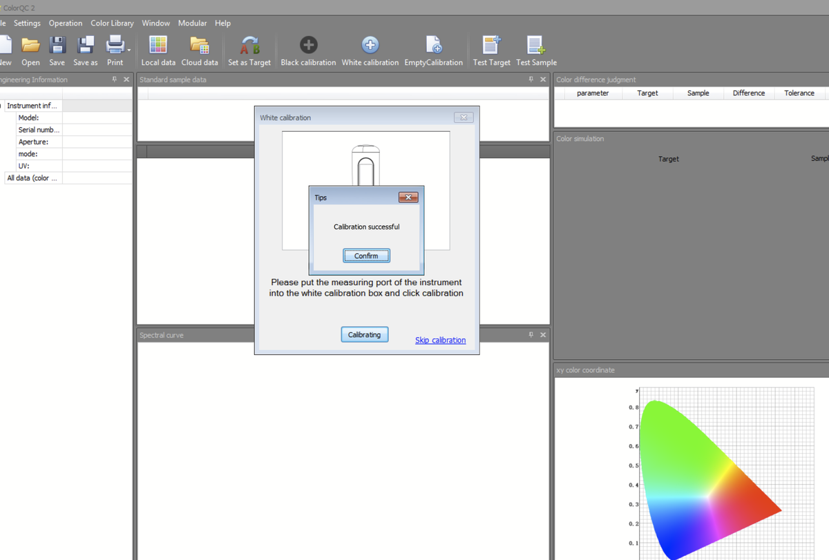

Press on the icon: test target and the ColorQC2 app will ask you to calibrate the black tile (which is hold the device about 1 meter from the ground):
After it is sucessful you will have to cap the spectro with the magnetic white tile to calibrate for the white calibration point:

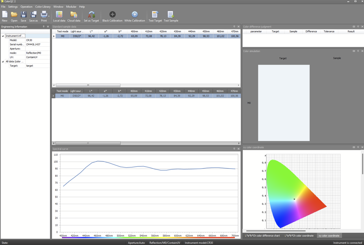

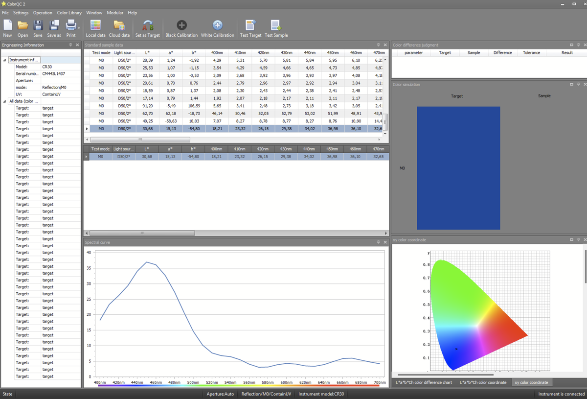

Now we start measuring: place the device on the first patch of the printer target and press on the button on top of the CR30 spectro: it will register the color value in LAB values and also the spectral data (which is plotted below in the graph):
Continu the reading until you have read all the patches of the target. A 300 patch target can be read in just about 10 minutes with some excercise:

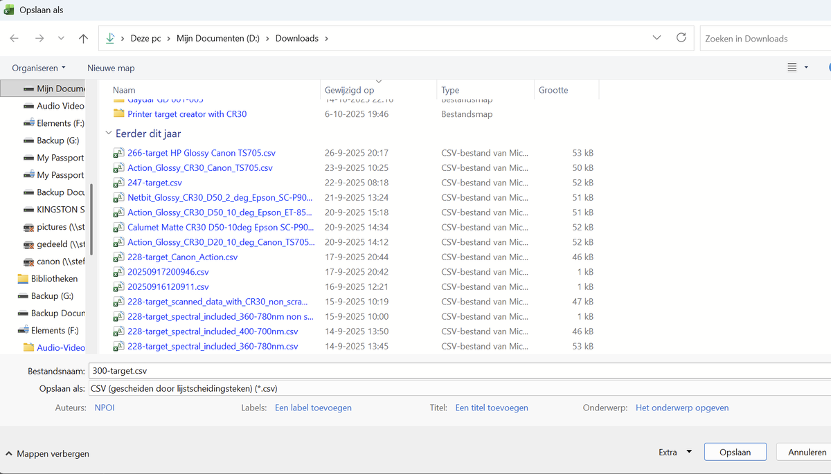

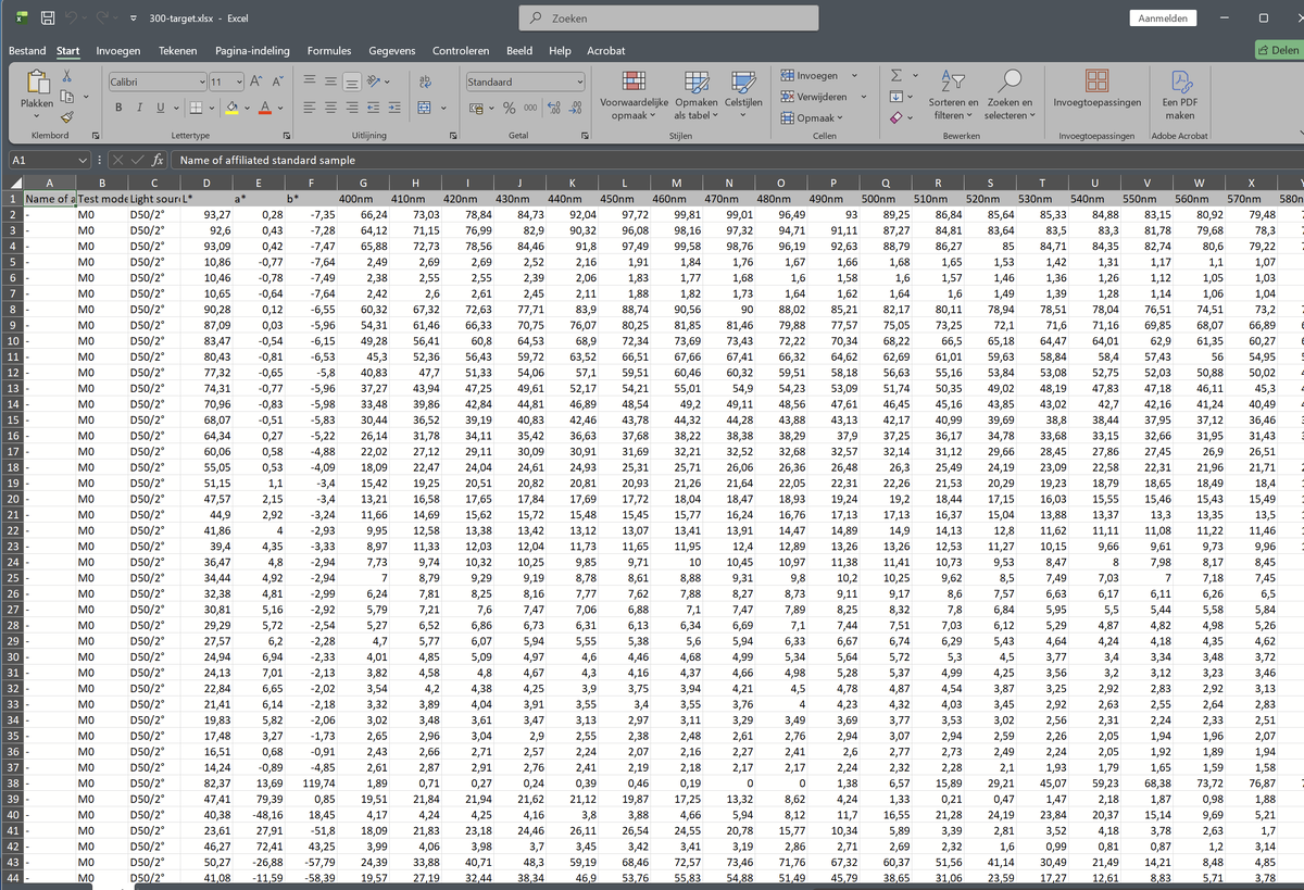

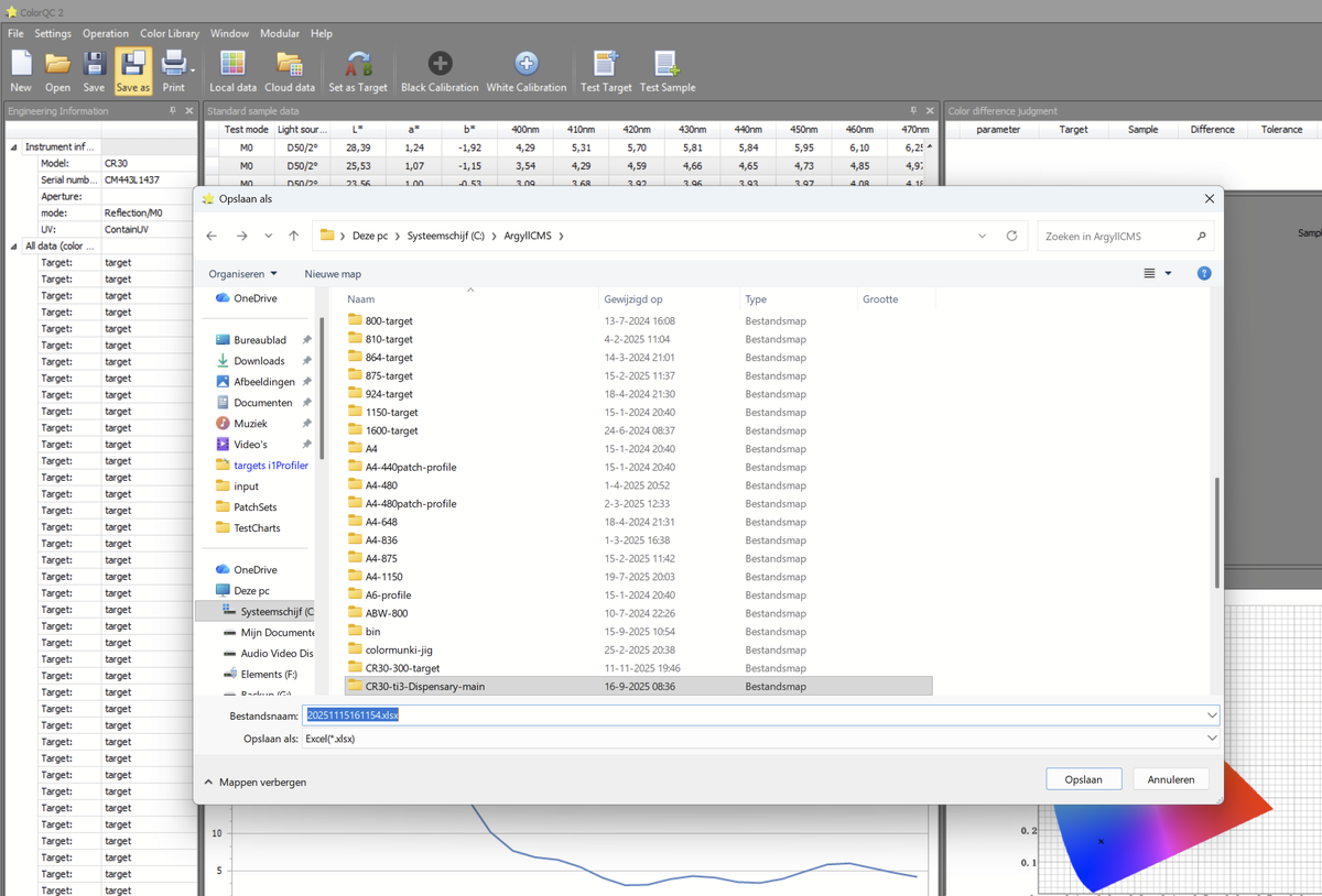

If you are ready will export the data as excel data and then from Excel or similar into a csv (comma separated) file. For some unknown reason direct export into a csv-file gives me a gibberish-like file which cannot be converted properly into a valid ArgyllCMS ti3 file. Not sure why this is case in my particular settings as others don't have this problem.
After you have saved the data in a Excel compatible xlsx file we will open the file in Excel and we have a look how many rows the data has. This is an extra control if you have done the reading correctly. A 300 patch target will have 301 rows (301 minus the upper one that describes the row corresponding column names below like LAB, measurement condition and angle, spectral data etc). If you have less or more than 301 rows than you have registered incorrectly and you will need to redo the scanning again:
Now we are going to export the xlsx file into a comma separated file which will be fed to the dispensary in order to create the ti3 file and ultimately the final printer profile:

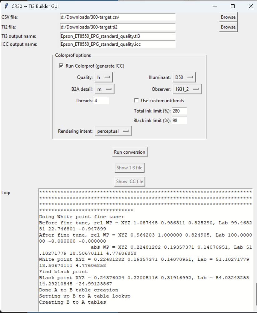

To pick up the first post I will now show you how to use the CR30 dispensary.
Thanks to @crenedecotret efforts to make a special randomizing ti1/pxf-file generator I managed to make a new 300 patch target for the CR30 which is finally randomized (in order to get a sharp in color/hue between adjacent patches).
Here is the link from @crenedecotret (pkpatches.zip) where you can add randomization of the grey patches into the ti1 file while remaining patch order in the ti2 file, which seems to be necessary for the CR30 dispensary python script to successfully generate the final printer profile.
https://www.printerknowledge.com/th...and-convert-to-i1profiler-patch-set.17122/#10
(post 10: pkpatches.zip to be used with python)
Install python (for Windows or Mac) first and use this github file set:
https://github.com/beerjongen/CR30-ti3-Dispensary (many thanks to @x64)

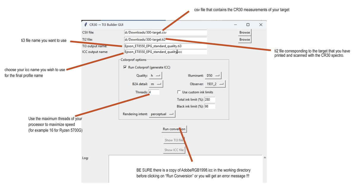

Start the gui.py file to load the app:
Load the csv-file that has been generated from your measurement with the ColorQC2 program (after you have first saved into a Excel compatible xlsx file and saved into a csv-file) into the app and also the corresponding ti2 file that belongs the target has been printed on the desired photo paper (for which you want a printer profile), properly dried and scanned with the CR30 spectro.
For most of us you can leave the rest of the settings on default settings.
Let the app generate your profile and after it is done you can install the profile by right clicking on your generated profile and choose: install profile in order to be available for all programs supporting color management.

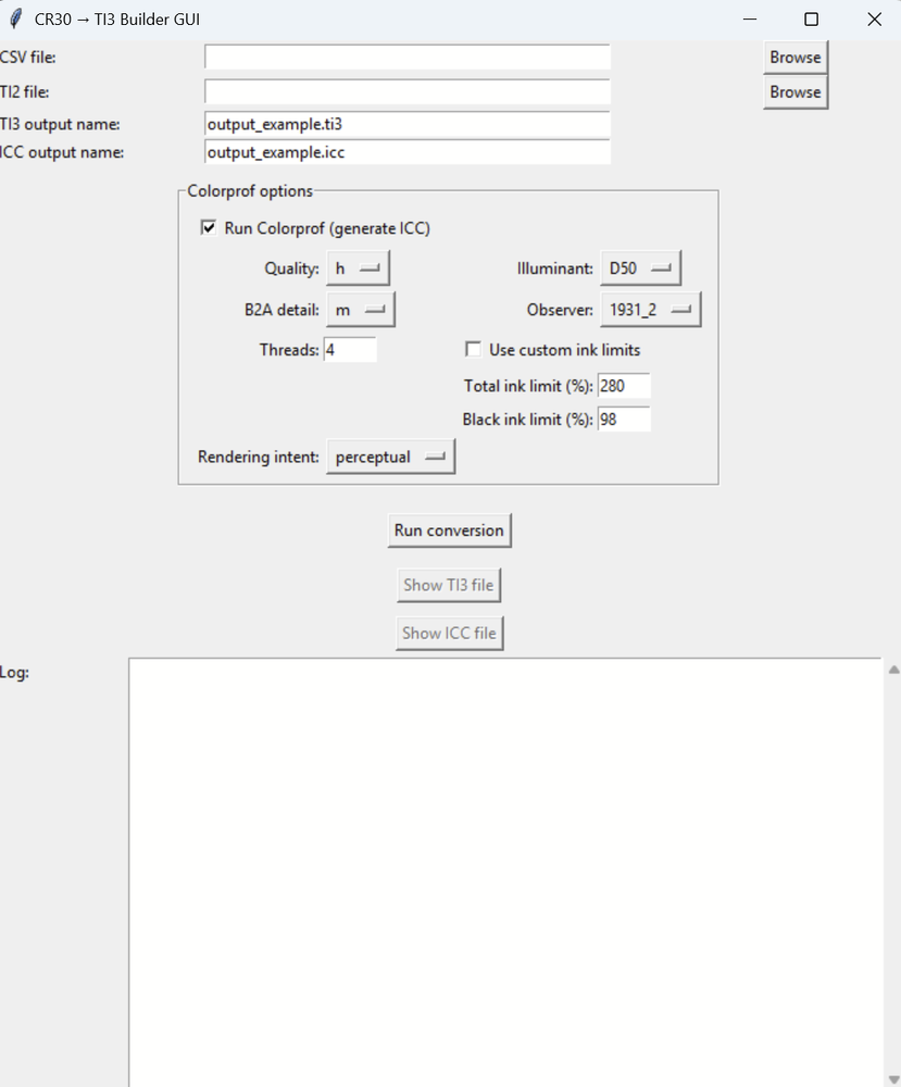

And is there an actual manual or concise source of essential info for this? I see things like "B2A detail" and "Total ink limit", and I have no idea what much of this stuff is.

just leave those settings on standard settings (B2A detail and total ink limit: the last one is for CMYK profiles only and you are going to generate a RGB printer profile).
