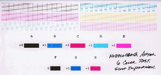

My last series of post were on the i560 printhead and the i850 printhead. This week I started working on an i950 printer and here is a picture of the first nozzle check after I turned the printer one and ran one cleaning cycle.
As you can see one half of the bottom group of nozzles on the Cyan set is not printing at all. Also you can see that in the Photo Cyan group, one half of the top group of nozzles is not printing. So this printer continues the mystery of how to identify which component is really bad.

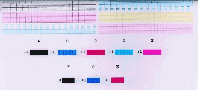

I ran a couple more cleaning cycles and some deep cleaning clycles and tried the nozzle check again. This is what came out.
As you can see, now the Photo Cyan group is missing one half of the top and one half of the bottom,...but they are different halfs. After this centered the printhead and unlock and relocked the printhead lever a couple of times,... then retested. There was no improvement.
Then I took the ink carts out and the printhead out and cleaned the contacts on the back of the printhead and the contact in the carriage asm using Isopropyl Alcohol. The new test after this showed no improvement at all.
Next I removed the printhead and did a complete cleaning cycle using hot water and Windex. Then I soaked the prinhead for 1/2 a day. The I dried it using my air compressor whihc is set for a max of 75 psi. I also used the air compress to force air backwards through the in k jets to force any dreid or clogged ink out of the printhead. I then re-installed the printhead, deep cleaned all the ink to prime the printhead, and retested. There was no improvement or change in any of the nozzle patterns. My next test will be to take the printer apart, remove all the printhead connections at the logic card, clean them, re-install them and then run a new series of test.
Because this nozzle check appears so symetrical I do not believe it has any thing to do with a clog. I am fairly convinced that I cleaned all the ink out of the printhead. If anyone has ever seen this nozzle pattern before, please respond with some data.
One other piece of information, I printed my standard 6 color bars in the size of a 5x7 photo. All six patterns of color bars were solid with no streaks at all. you would think after seeing that print that everything was perfect.

Trigger 37 said:
Does any one know just how small a force that is.
Its been a while since I did the calculations, but based on the surface tension of the ink and the diameter of the 2 pl nozzles on my i9900, I seem to remember that the nozzles can theoretically pull about 4 psi of vacuum. That may seem like quite a high suction for such a simple device, but remember that a tree uses the same capillary action to pull water to its top branches. Actually, there are several places in the ink link between the nozzles and the cart where such high suction levels cant be supported (especially when the printer is idle for extended periods), and they are probably the limiting factor in how much suction can be pulled on a cart.
How are you cleaning your carts? There is good evidence that cold water does not clean the sponge/filter nearly as well as hot water. Rubbing alcohol is also an effective cleaner, but you have to completely purge the alcohol from the cart before refilling or the ink will have the wrong viscosity and surface tension. I have encountered two carts that didnt work properly after purging, and the problem with both was that the sponge had been moved out of position. Tapping the cart to get the sponges back into position fixed both problems.
While the 8 pass overprint used by Canon on photos can apparently hide such severe banding problems, the loss of of the ink coverage in some colors will severely affect the color of photo prints. The loss of a few random nozzles should not be visible, however.

Grandad35,... I use the hottest water I can stand. Also, it seems much more effective to focus the hot water stream at the bottom of the printhead, direclty onto each bank of nozzles. Many times after I have clean a head, I let it soak in hot water for a couple of hours and then hit the bottom with a new stream of hot water. What I see is more ink appear at the filters when I turn the printhead over. This tells me that water is getting through the printhead from the nozzle side, and that there is still dried up ink inside the ink path but it is still being dissolved and coming out the top. I usually repeat all the process untill I don't see any more ink coming out the top of the filter screens.
This current i950 printer, which is a great 6 color printer, appears to have some kind of electrical disconnect somewhere. The other alternative would be some kind of defective logic board or faulty decoder EEprom on the back of the printhead. I'm still waiting to finish my testing on the i950, as I have a customer that despartly needs his MP730 repaired. It is a strange mystery,.. people think they can stop a paper jam after it has started by pulling backwards on the paper as hard as they can. Al this does is force the timing gears totallly out of sync. Resetting the timing gears on a Mp730 is easy,... the hard part is that you have to totally disassemble the Multifunction printer to get at the timing gears. Once you correct that problem, you can't even test it until you put the printer totally back together. If you do one thing wrong,... it's back to square one.
