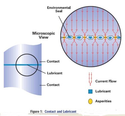

It might be thought that the lubricant needs to be conductive in order that the contacts would make good connections. That is not at all true. The lubricants are quite good insulators. Here is a quote from one of the articles that I previously linked to.
"If lubricants are insulators in bulk, how can they enhance the
performance of a connector, where contact resistance must be
minimal? The answer is found on the lunar-landscape-like
surface of a contact.
On a microscopic level, the contact surface is a series of
peaks and valleys. Current only flows where the peaks or
asperities touch (Figure 1). The actual contact area, therefore,
is rather small in some cases, less than 1% of the entire
contact. When the normal force on the contact is distributed
across the tips of the asperities, pressure increases to hundreds
of pounds per square inch, easily forcing the lubricant out of
the contact zone. In fact, tests show virtually no difference
in contact resistance between lubricated and unlubricated
connectors, however, there is an unmistakable difference in
connector performance and operating life."
