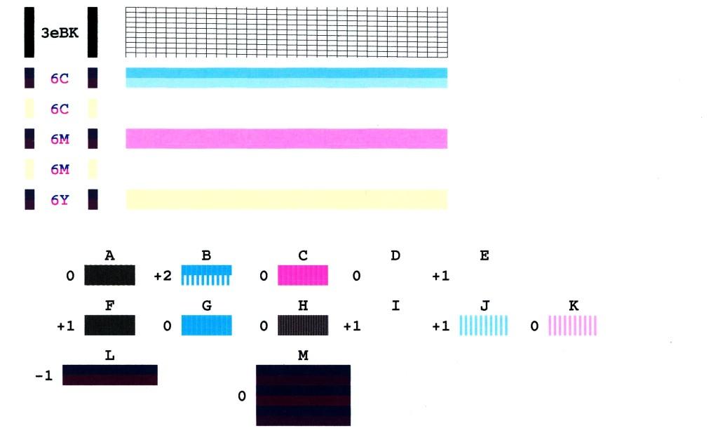

This is an example of one of the most difficult printheads I've had to deal with. The nozzle check below is of a MP730 (or i560) printhead just after I received it and did a basic deep cleaning cycle in an MP730 printer.
The black nozzles are very random and appear very clogged. The cyan wasn't all that bad but it shows what I have called the "Picket Fence" pattern. The Magenta has several nozzles that appear clogged and the same goes for the Photo Cyan or Photo Magenta nozzles. These are not actually "Photo" ink carts, just nozzles of reduced size such that the volume of ink in Pico liters is so small, the image appears to have been printer with a printer using Photo Cyan ink carts. After this nozzle test I did my normal cleaning process that I have used on many printheads and it has always worked fine. I basically flush the printhead in the sink with a stream of very warm water, turning the printhead over and over and focusing the stream at both the filter screens and the bottom of the nozzles. I do this until I don't see any more ink. Then I let the printhead soak in hot water (about 3/8") or Windex over night. In the morning a do a quick cleaning with a medium hot stream and see how much additional ink colors come out. When this is done I use an air compressor and nozzle to blow all the water out of the printhead, including from behind the contact board that holds the EEprom. I get the total printhead as dry as possible.
After the cleaning, I re-install the printhead and do a couple of deep cleaning cycles to prime the printhead with good ink. Then I run the nozzle test. If the results are not satisfactory, I do one or two more deep cleanings and repeat the nozzle test. If there is none or very little improvement in the nozzle check, I installed "Cleaning Carts" with 20/80 % solution of ink and cleaning solution I have purchase at one of the major ink suppliers. I then printed the color test bar image of Blk, CMY, with the cleaning carts and see if there is any change in the nozzle pattern.
Of the printheads I have worked on, about 95% are successfully recovered to full functionality. Then there are the other 5% that just don't seem to respond to any kind of cleaning. The image below is the same printhead shown above, but after I have done all the cleaning I have just mentioned. While the black nozzles have shown some good improvement, it is clearly not sufficient. This must have been a very clogged printhead. The Cyan pattern did not change one bit. The magenta pattern for both the 5 Pico liter and the 2 Pico liter nozzles got worse in that they also exhibit the "Picket fence" pattern. I cleaned the contacts on the back of the printhead and on the carriage with Isopropyl alcohol and re-did the nozzle check but there was absolutely no difference.
So the bottom line is that these results suggest either a change in the electrical condition of the decode electronics of the printhead, or somehow the clog in the printhead for the Magenta has expanded to block a portion of the magenta nozzles.
I remember with Grandad35 took one of the printhead apart, the insides showed that there were several open ports or paths where the ink would flow from the filter inlet down to each bank of nozzles. It does not seem likely that only the top portion of any bank of nozzles would be controlled by such a port, and it leads one to accept that some electrical connects has changed in the printhead. If this is true then this puts some part of the cleaning process into a serious question. The question is, which part.

I applaud your efforts to develop a method to identify when there is an electrical problem or a clogged print head. As has already been stated numerous times, the conventional approach of swapping print heads is risky on Canon printers because a defective print head can blow the mother board and vice versa. The situation is especially difficult for the average user, with a new print heads price often coming close to the price of a complete printer minus the ink carts.
This is why it is necessary to understand the construction of the print head under consideration. For example, the first nozzle check that you posted (copied below for reference) was produced on a printer with dye based C/M/Y and pigment based Black. As you stated, the Magenta and Cyan are printed in two different drop sizes to emulate the Photo inks. This is similar to the print head shown starting at (http://www.nifty-stuff.com/forum/viewtopic.php?pid=13158#p13158). Because the dark Cyan and Magenta tests are generated with ink from two separate nozzle banks, it is possible for an alternating Cyan or Magenta pattern (a picket fence) to be caused by a clog in one of the two ink supply channels. However, since such a clog would also affect the corresponding light Cyan or Magenta nozzle check, this doesnt seem to be the most likely cause of this problem, since both of those nozzle checks are normal. Another indicator that this might be an electrical problem is that exactly half of the pattern is missing. As is shown on (http://www.nifty-stuff.com/forum/viewtopic.php?pid=13256#p13256), there is an electrical discontinuity at the middle of each bank of nozzles, making an electrical problem more likely.
Your second nozzle check (again copied below for reference) shows that both the Dark and Light Cyan are missing the top half of one of the two banks. This missing areas could be from the same nozzle bank or from the second nozzle bank (we dont have enough information to say which), but they are again missing exactly half of the pattern (always the top half). The light magenta pattern indicates good ink flow to both magenta banks, making a clog an unlikely cause for the Dark Magenta problem.

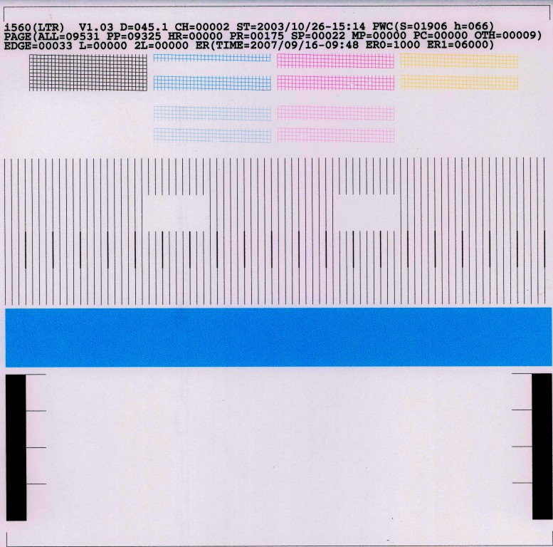

Back again,.. I've moved on to another printer, but it also uses the same model printhead. Again, this is an attempt to gain more knowledge on how to isolate problems with printheads between clogs and bad heads. The first picture below is a nozzle check after I had done only 1 cleaning cycle after hooking up the printer. In all of the pictures I have uploaded, each has been optimized for viewing in this web site by enhancing the contrast and color levels. This makes them much darker than what is real but they are much easier to see.
You can see in this picture that the lower half of the Cyan nozzles did not print. Also, neither one of the Photo Cyan or Magenta printed. Additional cleanings did nothing. Then I removed the printhead and cleaned it using my normal water rinse process and completely dried the printhead with compresses air. I re-installed it and did one deep cleaning process and the nozzle check came out identical.
Then I put the printer into Service mode and printed the Service test print show in this next picture.
As expected the black grid is just fine but the first Cyan grid is missing the bottom nozzles, same as the nozzle check. However, the big guestion is how did the Photo Cyan and the Photo Magenta grid patterns print, since they were both not printing in the nozzle check. While I was in the Service mode I went ahead and printed out the eeprom data and I cleared the waste ink counter since those pads had been cleaned. I don't think this could have any effect on the printing of the nozzle check.
So then I went back out of service mode and printed a new nozzle check, and guess what, now the Photo Cyan and Magenta were printing, but the regular Cyan still was missing the bottom half. The next picture shows the final nozzle check.
So the question to all the expert is,... how could just printing a Service Test pattern cause the Photo Cyan and the Photo magenta nozzles ot all of a sudden print, but also print almost perfectly. They did print rather good grid patterns on the first Service print but the question is , what is any possible connection. You should also notice that on the first nozzle print, there was no pattern printed for "D" or "I", and the "J" pattern was only half bars. In the final nozzle check, every one of these was perfect. It is magic????

I did some additional test to narrow down the possible things that could cause the problem of 1/2 of a bank of nozzles not firing. I believe the possibility of clogging is totally out as well as bad ink carts. That leaves, 1. a bad connection at the contacts on the printhead, 2. Bad cuircits on the inside of the printhead, 3. Bad signal driver from the logic board.
So to help isolate these, I took another printhead, with know conditions, and put it in this printer. However, first I did a test where I cleaned the contacts on the back of the printhead and those on the carrier with Isopropyl Alcohol and retested. This had no effect. I also did a small change to the printhead using a small piece of cardboard to force the printhead to move to the left as it is seated in the carriage. This will force the contacts to mate with the carriage at a different point. Again, this had no effect.
Now I tried a 2nd printhead. The results was that the section of the Cyan nozzles that did not print before, printed just fine. No need to upload the picture. This test eliminates items 1 & 3 above which leave the problem in the printhead. This also confirms that there is no clogging and that there was no problem with ink carts. It would be a very interesting test, if I ever get time to take each one of the contacts on the back of the printhead and insulate one at a time and then perform a new nozzle check. This should give us a table of symptoms that are 100% confirmed.
So on the last two printers I have worked on both have come up with a similar problem where only 1/2 of the nozzles in a bank of nozzles actually print. The i560 and the i850 have 512 nozzles in 4 banks of 128 nozzles each. As Grandad35 has shown, 2 of these banks are for photo size nozzles and two are for regular. To get the bad printing in the pictures above, the lower half of nozzles in two different banks are somehow missing the firing signal. That points not to wiring but to a decoder circuit. The real sad point of all of this is that Canon technical support people at their main plant have detailed reports and diagnostics to isolate all kinds of fails like this. At IBM we did these kind of "White Papers for each product we ever put out. They were call failure mechanisms. After all Service was our most important product. I don't think I can hold my breath until we see Canon ever put out information like that.
If there are people out there that know more about how the decoders work and what specifically could fail to cause this kind of printing, It would solve one piece of our puzzle.

Trigger 37 said:
...snip...To get the bad printing in the pictures above, the lower half of nozzles in two different banks are somehow missing the firing signal.
As I see your nozzle checks, only one of the two banks is missing its bottom half - the other bank is working normally:
1. The bottom of the "6C" cyan bar isn't completely missing - it's at half strength.
2. The "B" test bar is half filled on the bottom.
These studies are very interesting - we get to see the results while you do all of the work. This study tells us that the problem was in the print head - either a clog or an electrical problem. Given the nature of the print head's construction, it is difficult to see how two banks of nozzles spaced only about 250 microns apart (the width of 3 human hairs) can share the same ink supply channel and have exactly 1/2 of one bank clogged while the other bank functions normally. This sure looks like an electrical problem.
I haven't been keeping track, but does it seem like the bottom half is usually the missing half in this type of failure? As you said, Canon undoubtedly knows what causes these failures.
The real goal is to know when the problem is in the printer and that a replacement print head won't fix the problem (and may be damaged in the process), or when a replacement print head will fix the problem.
