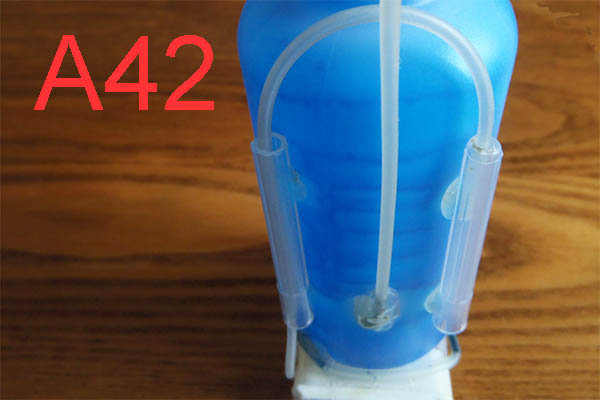

The ink tank has now been completed (is made).
wss
Sep 8, 2012
22
21
I don't understand - at the last photo - the central pipe which goes (i.e. where it enters the bottle) above the other two sides of the curved pipe - is it for air ? Can I make it near the cap or in the cap of the bottle ?
And what the curved pipe is for - also for air, to reduce the amount of dust ????
thanks
turbguy
Sep 10, 2007
1,562
1,442
Laramie, Wyoming
Canon i960, Canon i9900
I agree with potential confusion arising from the photos.
Can you provide a schematic of the completed design?
