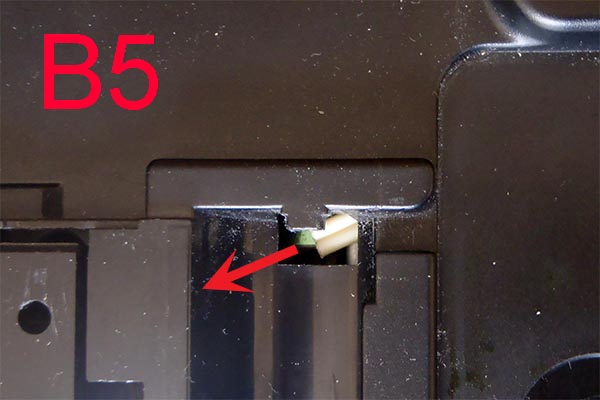

While inserting a flat-blade screwdriver, etc. through into a space under the main case cover; and
pressing the claw downward, slide the main case cover toward the front side of the printer.

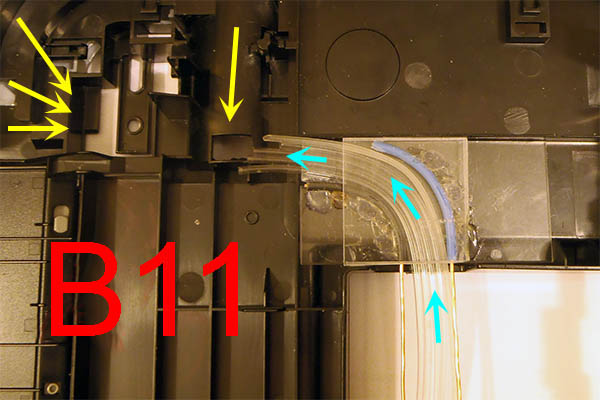

The path tubing takes into the printer, tube bend, etc... is all highly relevant to any CIS system installation so information like this while perhaps a bit verbose is still useful. That said, inclusion of some keywords so that someone wanting to know how to take the top off this particular printer can find it, would be useful.

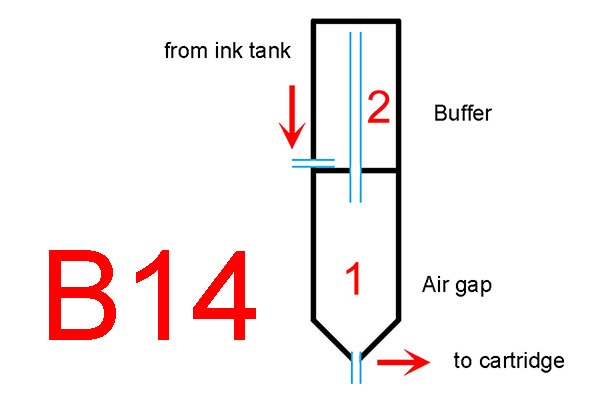

CISS: separate tubes from needle-butterflies.
The cartridges are in the position "printer off".

I changed the inner air gap h1 into the outer gap.
