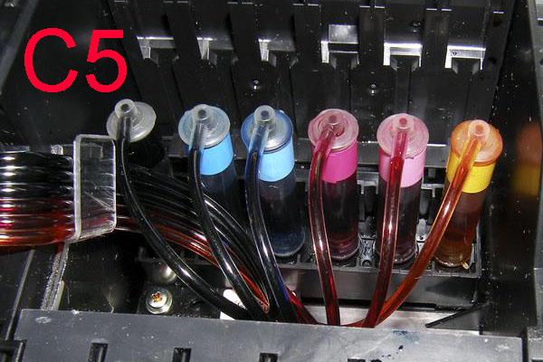

Professionals say that the connection C3 is better than C2.
Do you know about the capsules? Professionals say that the capsules are better then C2, C3.
Capsule with two cameras (chamber) is better:

This is the shelf for ink tanks. Made from one CD box. Lack of strong construction.
Other strong enough construction.

My tubes positioning option.
Remove the the access cover:
