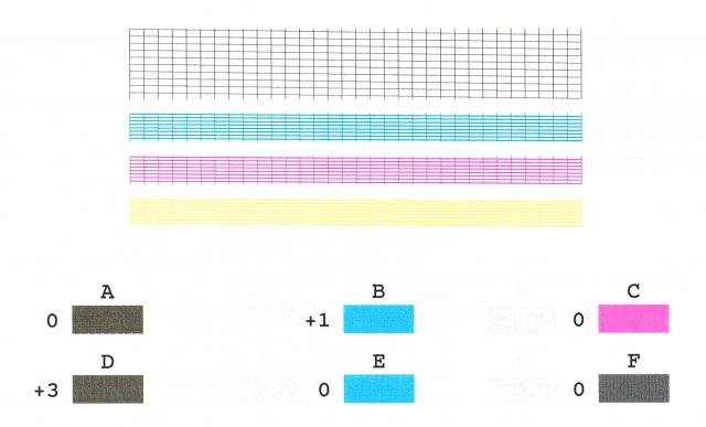

I just acquired an F50 and am trying to get it printing properly.
The manual (and online copy at Canon USA) are in black and white,
and there appears to be no other indication of which colors go where
on the nozzle check page. I'd greatly appreciate a post of, or pointer
to, an image with the correct patterns.

Tony,... Wow,... you are lucky you didn't kill your printhead. It does sound like the leaking black you have could be from the printhead. Is it still leaking. When you say "Nozzle area" do you mean from the bottom of the printhead.
The nozzzle check pattern looks very similar, if not identical to the Canon i550 printer. I have both manuals but I already have a sample print for the i550 which I have uploaded below. Click on the image to get a large picture.
Scan one of your nozzle checks and upload it to your next post. Go to the very top of the forum and you will see the "Upload". Select the browse function and find the scanned image and select it. Once it is uploaded to that page, click and select all of the html text. Then back up two pages to your post and paste the HTML text to your post.

Thanks for your response and helpful suggestions, Trigger37. Unfortunately, the printhead needs replacing, though I don't believe that I killed it.
One other detail that I didn't mention in my original post is that when I first separated the head from the plastic housing, the flex circuit separated from the edge of the white substrate of the head (the glue and soldermask remained stuck to the head). The tracks on the flex circuit appeared to be intact, so I didn't consider it to be a problem.
After another dissasembly and manual cleaning (with water/IPA/ammonia solution) didn't improve the test print, I took the printhead to work and examined it under a microscope. No sign of ink was left on the head or input ports, so I looked at the tracks on the exposed area of the flex circuit. I was surprised to see discoloration and erosion of the copper. At first I thought it was black ink residue, but cleaning with IPA didn't remove it. I used a knife to gently scrape away some of the discoloration, which made the erosion of the sides of the tracks that much more obvious. Maybe the tracks were partially lifted when I pulled the flex away from the edge of the head? No, there was no sign of copper on the glue/soldermask attached to the head. So I've concluded that the area is corroded, but by what? The glue? Ink or moisture seeping in through a void in the soldermask, which combined with voltage on the tracks to erode the copper? I applied more ammoniated cleaning solution to that area to see if that had an effect, and confirmed that it did not.
While there are no obvious breaks in any of the traces (most of the tracks are too fine to get meter probes on them to check continuity), I think it's likely that the intermittent problem I was seeing was electrical, and there's no sense in investing any more time or effort in this printhead. If I can't scrounge one up locally (just missed an F30 on Craigslist for $10), I'll order one from ebay.
Thanks again for your help, and for posting the actual color check pattern. I still find it strange that it's not available from Canon.
